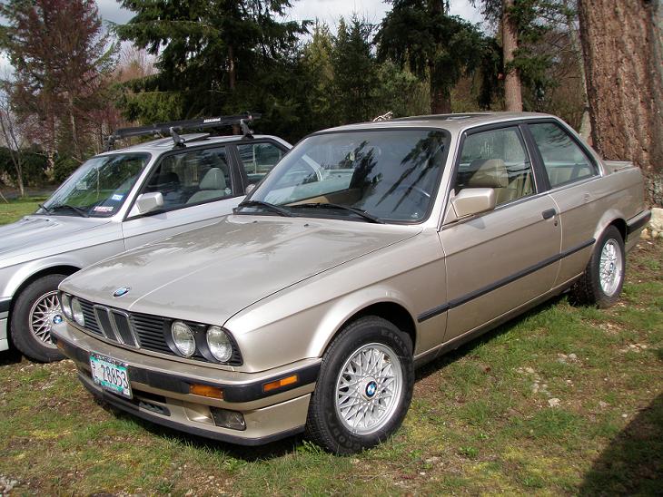

            just bought a M30 E30 !
            you'll hear from me soon enough, as this is my first E30 period, I will have a lot of questions as soon as I'm out school for the semester.
            09/1989 325i 4 Door
            +M30 Swap
            +Z3 Steering Rack

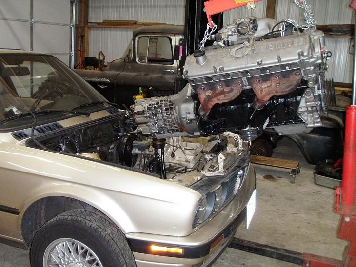

              M30 swap soon to be gt42 powered!!!!
              Hey guys wanted to post up some swapped e30 pic's. If things go well and i sell my supra im planning on installing a gt4294 turbo on it and making around 400-500 whp with it.
              Started like this. No engine , wheels, hood, etc...
              Ended up swapping a 1984 733i power plant. during the install i added a set of stahl headers.
              Now
              Dyno dynamic's numbers
              It did 150whp on a dynojet the next day. the car had has loud valves and leans out up top to 14.5 afr. Im hoping that i can use a ecu from a 1987 535is and chip it to help out the low power????

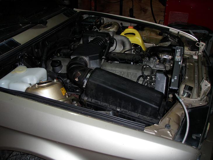

                        Things done recently by me/ local shop:
                        2 views, 3 likes, 0 loves, 3 comments, 0 shares, Facebook Watch Videos from Dynotech Motorsports: Dyno Test/Tune E30 M30
                        *New Head Gasket
                        *Radiator
                        *Moved motor back 1/2" - 3/4"
                        *Coolant system hoses (all new)
                        *New Fans
                        *A/C install
                        *Painted Wrinkle Black
                        *Turner Chip
                        *Spark Plugs
                        *TPS
                        *ICV
                        Soon to come:
                        *CAI?
                        *New Coolant tank
                        *New Oil Cap
                        BEFORE:
                        AFTER:
                        • White5
                          • 149
                          #87
                          Does anyone know if I'd be better keeping the stock M30 airbox or if I should go with a custom cold air intake? The cold air has a metal barrier custom built for it to keep as much hot air away as possible but the more I read the more I wonder..
                          Thanks

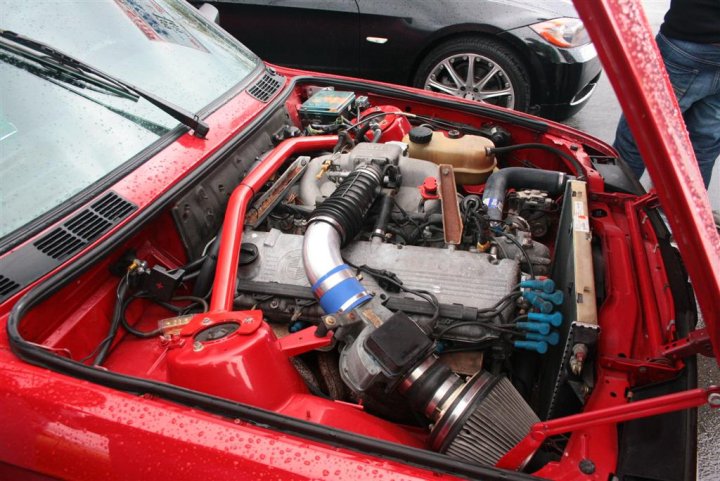

                              #89
                              1988 zinnobar red tourer
                              E34 M30B35
                              e30.de engine mounts
                              E34 manual 5spd trans
                              E28 ligtweight fly with matching clutch
                              B&M race quick shifter
                              Sebring stainless steel exhaust system
                              E30 M3 prop
                              3.91LSD
                              E46 330ci clubsport steering rack (3 turns lock to lock)
                              Powerflex bushes inc eccentric fronts
                              Bilstein B6 shocks
                              Apex 60/40mm springs
                              Brembo discs and fast road pads
                              Nearly every BMW option ticked from new ;)
                              Just finished putting the M30 back together after replacing all gaskets and seals with ultrasonically cleaned injectors. Can't wait to get it back in
                              Charlie
                              88 335i zinnobar tourer fully loaded ;)
