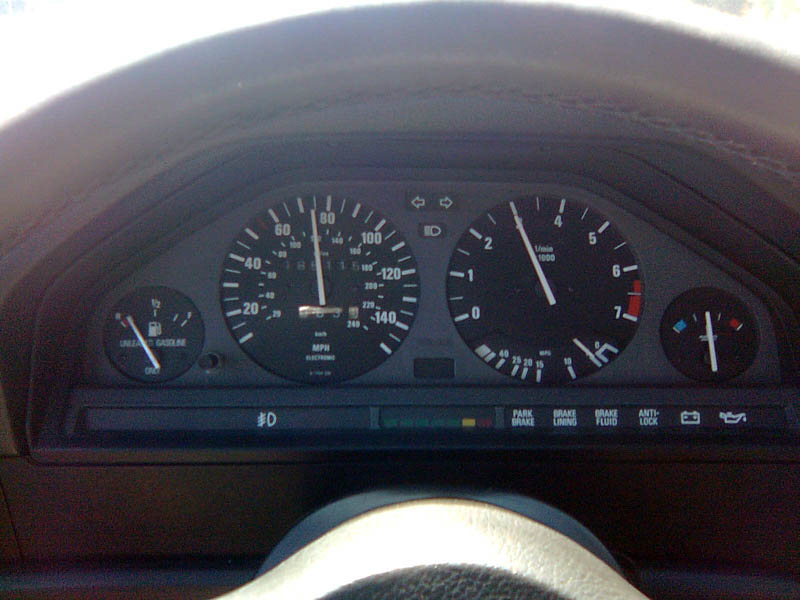

    My early cluster does not have a coding plug in the front, so I just installed a good late model cluster.
    Got a good SI board today, all is good now. Now to fit the AIR intake box and wire in the check engine light bulb and see if it will pass smog before I head down to BAR.

                  I am at about 75 mph @ 3k rpm in 5th. Using s3.73 and getrag 260/6 with 14" 195/60 tires. I think I am getting about 23mpg right now in mixed driving, mostly city and short trips. Will have to try hard to keep it under 3k rpm for a full tank and see what it does then.
                  I need to find that online caclulator to find out how it would change if I switch from s3.73 to s3.46...
