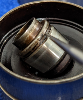

          For information puroses... This is the retaining ring/clip that I'm talking about. I've already got the centers out of the larger housing. Based on what I've seen in videos and stuff I think that ring usually stays in the larger housing and the spring clip comes out of it. This allows the piston to come out (left of my pointer) easily and the internals to be cleaned properly.
          However in the 9 that I've taken apart so far the ring seems to be rather securely attached to the center. I'm leaning towards using the vw units now anyway.

            I can't immediately verify the PN for the lifters, but there is/was a spec comparison out there.
            Now I sort of want to take an old lifter apart just to see how it works.

              pretty good video on it.
              This one is for an e36 unknown engine, when he knocks it out it kinda looks like the retaining ring just stays in the outer piece.
              • NC325iC
                • Mar 2004
                • 6565
                After looking at that second video again I'm starting to think they may just be an older design in the m42.
