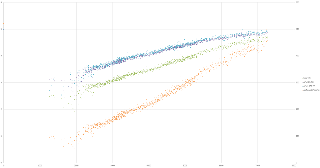

      Plus a couple ghostless WOT logs from around 2000
      Click image for larger version  Name:	ghostless wot log.png Views:	0 Size:	280.6 KB ID:	10057828

        lol yeah, I imagine that would cause some strange readings...
        It looks like the resonance that I have observed in the 2500-3500RPM range is very possibly due to some interaction of the stock intake with the AFM. There looks to be no sign of it in your data.

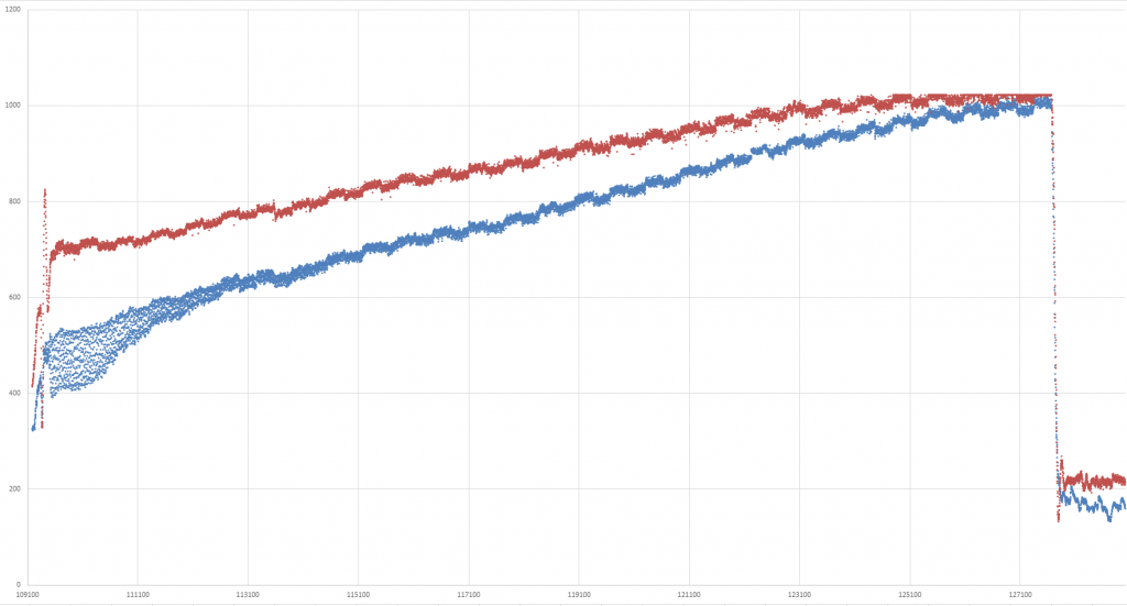

                      did a test today, it was around 1 kHz (it didnt let me upload the xlsx ):
                      theres something going on it seems, but its strange that AFM and MAF are both so similar in showing those "oscillations", would have guessed they react very different to actual varying airspeed...
                      blue=MAF; red=AFM
                      WOT Pull starting somewhere from around 1500/2000 to just after 7000
Name:	log over time.png
                      • bmwman91
                        • Oct 2004
                        • 3134
                        There will be EMI and electrical noise, although there is a lot less than I'd expect for an unfiltered reading (or did you put an RC filter back in place?). The fact that both signals show the same pattern, and that it looks like a regular pattern rather than completely random, is pretty interesting. Depending on the topology of the ADC in the microcontroller, there can be issues with 'ghosting' between channels, usually when there is a single sampling capacitor multiplexed with multiple inputs. A signal with high input impedance (such as one with even a few kOhm resistor inline as part of an RC filter) usually makes this worse. Residual voltage from one channel can bleed into the next channel's reading if there is not sufficient time between samples since the capacitor needs to charge/discharge to the level of the next signal input. I assume that the Arduino code you have runs a main loop at 1kHz, with the AFM signal being sampled and then immediately followed by the MAF signal, and then some 'dead time' until the end of the main loop? How is the grounding set up between the Arduino and car/signals?
                        The larger oscillations from the MAF signal make sense since they are present what looks like the lower RPMs at the start of the WOT pull. Low pass filtering is always a trade between group delay (how much it delays the output from matching the input) and both filter cutoff sharpness and how low the passband frequency is. So, on a 4 banger going WOT at 2000RPM, the filter isn't fully attenuating the ~67Hz oscillations.
                        You can see one of the characteristic downsides of the AFM in this plot...at the start when you snapped the throttle open, you can see that the output swung high as the momentum of the door carried it past where it should have been, then it rebounded, and then settled into proper reading. The MAF has none of that, although these old ECUs do not always love the oscillation in the MAF signal.
                        Anyway, it is really cool that you were able to bump the sampling up to 1kHz. You can get a much better idea of what the signal actually looks like.

                            Regards the 1kHz log: It was MAF and AFM without any filtering directly to the Analog-Pins. As you guessed its just 2x AnalogRead and then directly Serial.print.
                            Most of your post is over my head
                            What i didnt expect was that the MAF hit in a pretty wide range at first until it settled to a more narrow spread. The AFM (minus the overshoot ) was faster to a stable reading/narrow spread.

                                Originally posted by bmwman91
                                The M42 AFM transfer function. I actually got this directly from Bosch, and while I can't share the documents I got from them, this function very precisely represents the sensor's behavior.
                                Thats awesome
