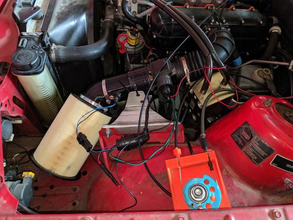

        Here's how my thermistors are mounted (I used 2 MuRata ones, one for the ECU and one for the converter, although I could have just used the one for the ECU). You can see it part way down in this post of mine:
        I converted to an M30 air box since it uses an air filter that has ~75% more surface area while also being the same width as the original M42 filter box. It required some minor welding modifications to the PS reservoir bracket, but nothing major.

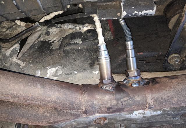

          I finally found a supplier where i could order some thermistors that are close, what an ordeal that was
          Still waiting for the pins to do the WBO2 harness.

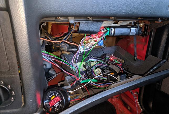

          Been looking into how to do the wiring decently clean and without disturbing the original harness too much. Do you by chance know what type/manufacturer the AFMs stock 7 Pin connector is from. I thought of getting the AFM side connector to wire in the MAF and IAT and have it looking stock-ish (similar to how you did the IAT). But i had no luck finding out what type this is. BMW sells the side i already have on my harness (# 12521737668)
          The one you used for the IAT sensor looks like the MAF connector on my Siemens MAF (4-Pin). Where did you find the male part of that? Is it this one # 61131393773 ?

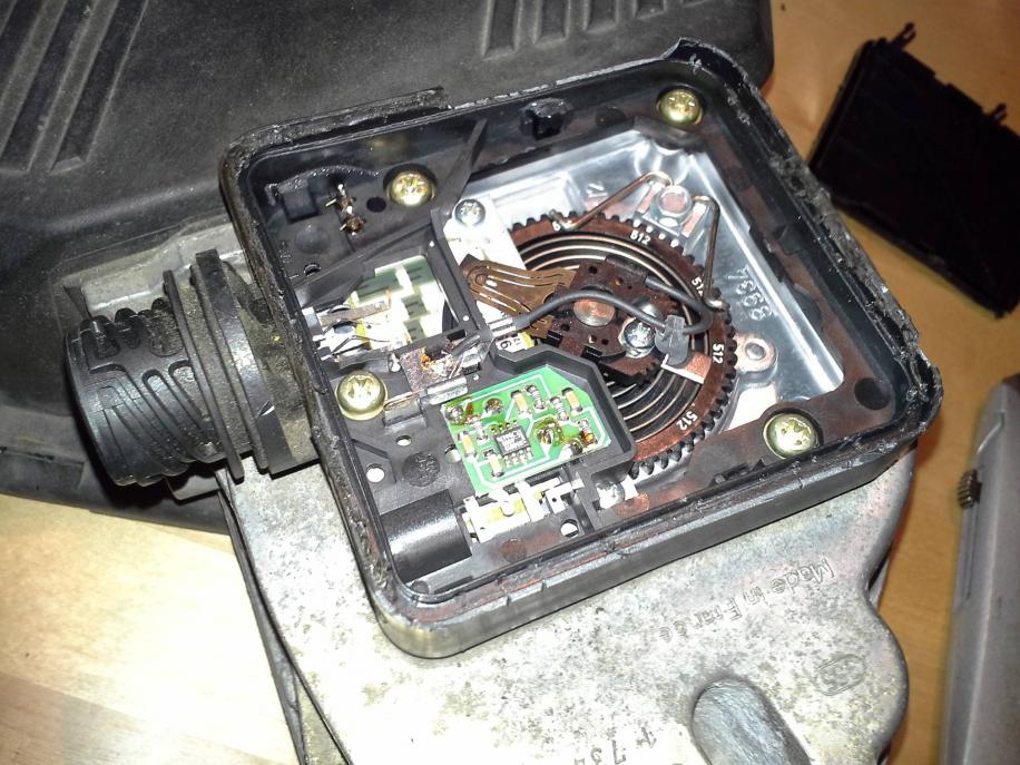

                  Then i had a look at opened AFMs online...there is some sort of circuit in there. I guess its something to do with checking the resistor track quality or just generating/filtering the AFMs output just guessing at the moment

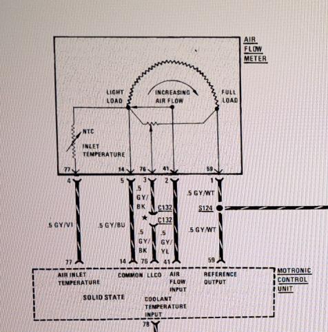

                  But that schematic with just resistive elements is obviously not the whole picture here!

                    The little circuit inside your AFM is just a little active low-pass filter. You must have a newer version of the AFM since I have only ever seen that little circuit inside of an adapter thing that goes between the AFM and harness. Supposedly the M42 had some idle stability issue that required this to smooth it out, although I've seen no difference in how the car runs with or without it when I had an AFM in there.

                      Oh ok =) then it should be like the schematic after all
