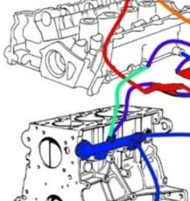

        Two questions..
        1. Is there a better hose option for the water pipe to head (green in below pic) than 5/16" bulk hose with a smaller hose shoved in the end to fit the head?
        2. Any reason why I shouldn't replace both water temp sensors while I am doing this project? They are the same, yes? I am inclined to just order 2 sensors and move on

          Originally posted by GarageBound
          Two questions..
          Go to your local parts store with a close template and the end sizes you need, convince them to look at their wall of hoses for a close molded option, post the result here. You need to look again at the sensors in question, they are not the same, and unless they test as bad I don't see why you would replace them.

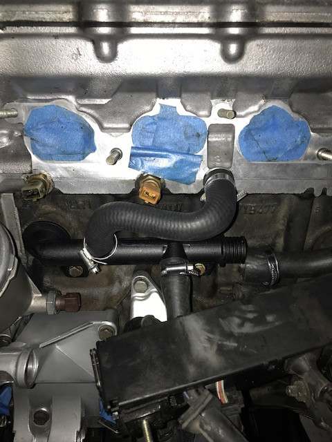

            roguetoaster - visited a couple of local parts stores and resulted in finding a possibly great solution.
            A slightly twisted, pre-bent Continental hose (#B71231 63036 s) when fitted with a small slice of original sized (diameter) insert fits and looks perfect.(note left clamp not yet tightened)
            The only concern is, can this other hose sleeve insert approach as demo'd in the mess video, hold pressure for another 100K?

            • roguetoaster
              Biggus Tippus
              • 7830
              So you put a hose within a hose?
              Maybe some RTV between the two might be in order, but I don't know how effective it will be either way.
              • bmwman91
                • Oct 2004
                • 3134
                Clever idea, but it seems risky. Personally it is not worth the risk of a leak, either a small one which requires pulling the intake again, or a major one that leads to overheating.

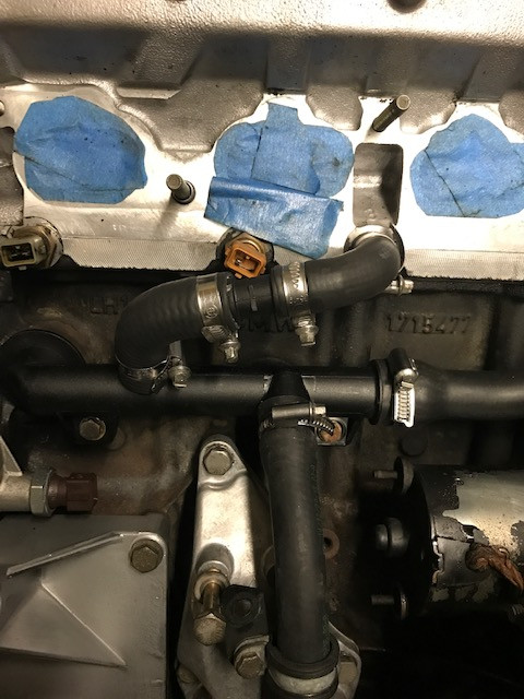

                  BTW my next approach is: (from water pipe to head)
                  5/8" elbow (pre-bent ~90 degrees) >> plastic heater hose reducer (5/8"-1/2") >> 1/2" elbow onto head port.

                    • GarageBound
                      • Feb 2022
                      • 37
                      After more research, I found this thread that calls out the approach to use a BMW pre-bent hose for a E36 M42. https://www.r3vlimited.com/board/for...oolant-leaking
                      I decided to proceed with my 5/8" elbow (pre-bent ~90 degrees) >> plastic heater hose reducer (5/8"-1/2") >> 1/2" elbow onto head port. I am confident that it will hold as just replacing the stock mess. Moving forward!
                      • roguetoaster
                        Biggus Tippus
                        • 7830
                        Looks fine to me.
                        • bmwman91
                          • Oct 2004
                          • 3134
                          Nice find! That is more or less what my solution looks like, but yours is a bit cleaner since the hoses you have are pre-bent to a sharper corner. Good stuff!
