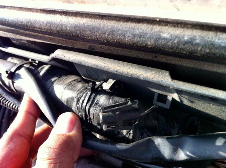

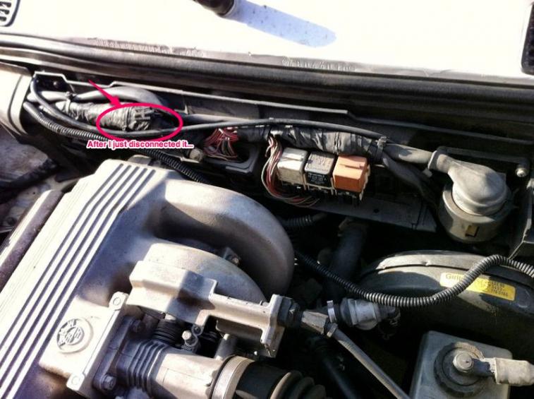

              i believe you are experiencing the m42 'hot start' issue. You need to disconnect the grey wire/connector on your engine harness on the firewall, it should not be connected. It relates to the LLCO connection to the AFM and should not be connected on US catalyzed engines.
              My vehicle is a non-cat version and when the receptacle is disconnected the idle goes to crap. When I set the scanner up for the "cat version" and look at the engine data, reference voltage for the O2 sensor is present.
              It appears to me the ECU is set up for both cat and non-cat applications and the connector is sort of a "switch" if you will. EDIT: The eprom is actually the "switch" so to speak. US Spec #1.267.356.378; Euro-spec #1.267.356.214
              -If connected the DME looks for an input signal from the Idle Speed CO Pontentiometer, but it must have the Euro-spec eprom #214.
              -If disconnected the DME looks for input signal from the Oxygen Sensor, but that is for US spec eprom #378.
              The DME (aka ECU) part number on the case is the same for both US and Euro markets (0261200175).
              I had this problem where the car would start up perfectly on cold start, but on hot starts it would barely idle/stall/not rev for about 15 seconds when it would sudden clear up. On the wiring diagrams look at page 1360-4 by the afm
Name:	Wiring harness location.jpg
Name:	Wiring harness closerup.jpg

                Awesome, thank you all for the advice. I think Downforce might be on to something here. The car had been in an accident in its life and I think the wiring harness was messed with so let me see if something was plugged in that shouldnt be.
                Will report back!
