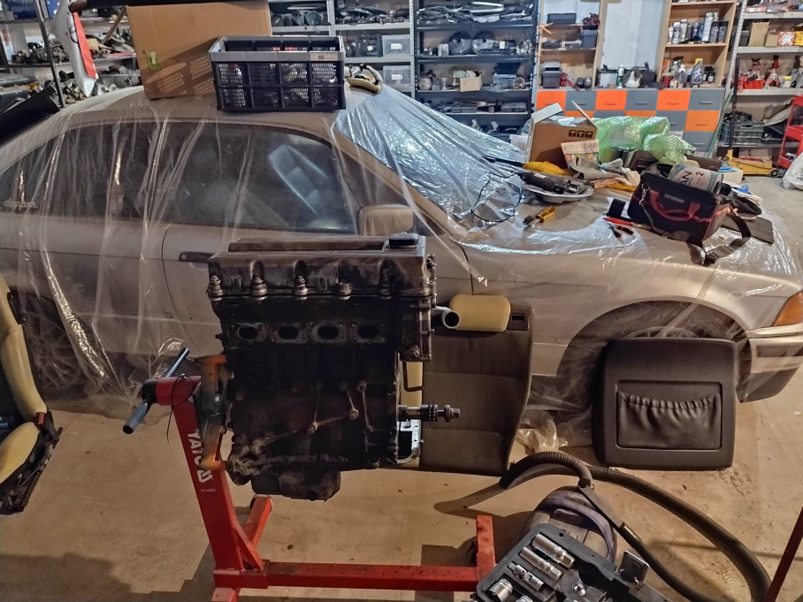

    Hi guys.
    A couple of years ago I decided to convert the M40B18 in my E30 to an M42B18 using parts from several engines I've had in storage for a while now.
    The primary reasons for this conversion were drivability, reliability and parts availability. The M42's engine management (at least the motronic 1.7.3 that comes on later e36 318is) seems to be a bit more flexible and more permissive when it comes to small vacuum leaks and other small issues. It also does not use a distributor for ignition, and all hoses and gaskets can still be found new, OEM and aftermarket - as opposed to M40 parts. Simple stuff like the M40 rubber intake boot are getting very scarce. I'd driven a couple of years with a taped over intake boot in my 318i because no retailer in my country would stock the part. After 24 months I lost patience and ordered one of aliexpress. I got the wrong part - they sent the E36 intake boot which is much longer then the E30 one. Then I caved AGAN and ordered an original BMW part for almost 200$ - as well as a double water and air hose specific for the m40... but still no luck. The intake boot was sealed, and already cracked. The other hose was fine. BMW refunded me for the intake boot and said the newest lot for that part number is dated 2004... so take it or leave it. I left it.
    One day I was taking inventory of engine parts and came across two sets of e36 M42 intake manifolds, 3 wiring harnesses, all e36, one pre 94 and two post 94, 3 cilynder heads, 10 pistons, two crankshafts, timing chain covers, oil pump, 4 DMEs, everything I'd need for the conversion. I had a look at the part number on M42 and M40 engine blocks, they are the same. The only difference is the lack of bosses in the block for knock sensors on the M40.
    And here is issue number one: my engine is finished, the car runs, but I don't have any knock sensors installed. I haven't tried connecting any scan tools to the car, I think maybe BMW scanner MIGHT work. The engine runs fine, idles well, revs well, no weird noises, minor oil leak at the timing chain cover despite using new Elring gaskets all around (should have added a dab of RTV I guess) - but the car seems slow... not "there's something wrong" slow, just... M40 318i slow... keep in mind since I did just rebuild the engine, I'm not willing to rev past 4k RPM just yet, and I am taking it easy on the old girl until it does at least 2000km, but so far, up to 4k rpm, I can't feel any difference between my old setup (M40b18 with M42 fuel rail, injectors and AFM) and the new setup.... Is it possible that the lack of knock sensors is causing the engine to run in a "safe mode" of sorts? Would it be possible to "code out" the knock sensors from the DME? I really don't want to drill holes in the M40 block, and even if I did, I read the knock sensors are finicky and need to be placed on the block exactly where BMW put them - that won't be possible. I can't glue them on - I could drill into the block or weld a nut in the same location as on the M42 block and screw the knock sensors in... any opinions on this idea?
    Issue 2 - my engine runs a bit hot. The needle sits in between the center mark and the one further to the right... If I push it a bit harder, it will move closer to the 4th mark on the gauge (to the right) - if I take it slow it stays nearer to the center. If I turn the heat on it will move closer to the center mark. Could it be a gauge issue? I know e30 gauges are problematic. I tried reading engine temp with an IR thermometer and the radiator is 70-78C while the head reads 88-90c. I'm using a brand new NISSENS E36 318is/320i radiator. New water pump, thermostat, fan clutch and hoses of course.
    Issue 3 is, as mentioned above, performance - seems similar if not identical to the M40, at least up to 4000rpm. I don't particularly mind if I don't get this one sorted, as I plan to be gentle with this car. It's purpose is leisurely weekend driving for relaxation so It's OK if performance stays the way it is, but it would have been nice to be able to feel some extra power after all that work.

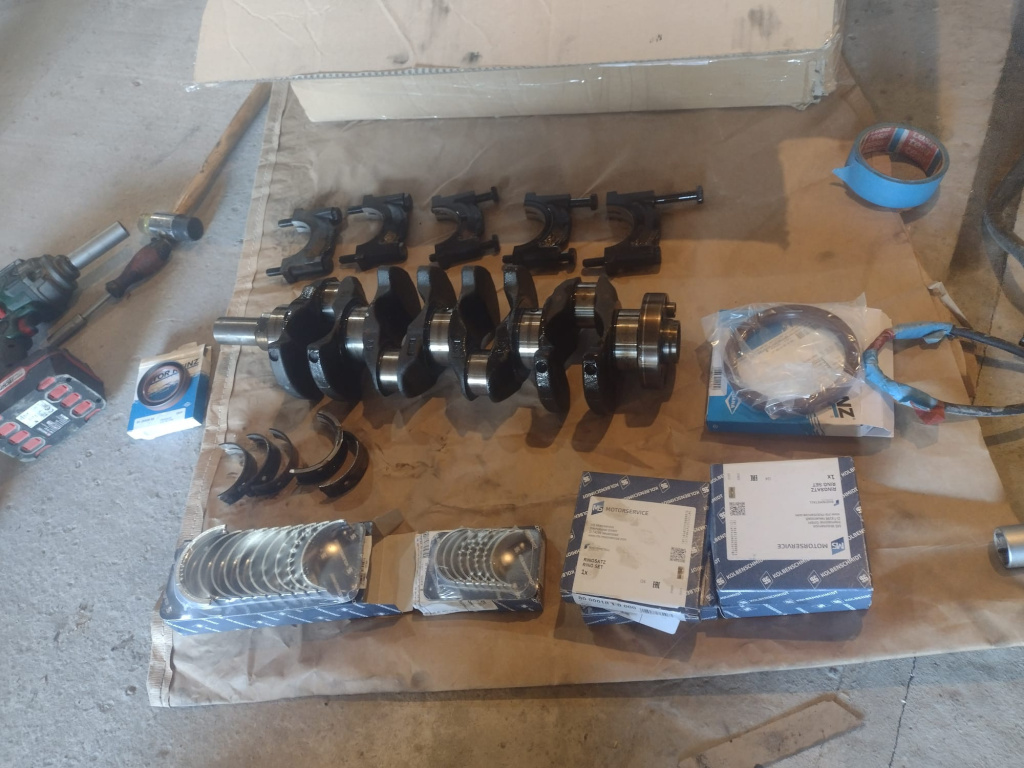

    Some details on the build:
    The engine is completely rebuilt with new parts, took me 2-2.5 years to finish. All gaskets, sensors and hoses are new (with one exception - the crank ventilation hose). New rings, new shell bearings, polished crank, rebuilt cylinder head (valve seats, decked, valve stem seals). I also did a coil over plug conversion so I would not need an ignition coil bracket witch my car did not have and so I can get rid of the spark plug leads. I'm using M52TU ignition coils. I'm using the DME from a '96 e36 + the wiring from the same car. I kept only the engine block and oil pan from the M40. I installed the flat belt pullies and power steering pump + alternator from a post 95 e36 to get rid of the constantly squealing v-blets and to make it easier to install a modern AC compressor on the car. The gearbox and final drive are original to the car, and I used the single mass flywheel + clutch kit I had on the M40 as they are in near mint condition. I used the oil pump/timing case setup from a later 96 engine that uses a plastic slider instead of the pinion for the lower left side of the timing chain, as I've had issues with those pinions on early M42 engines in the past.
    Any advice and input is welcome!

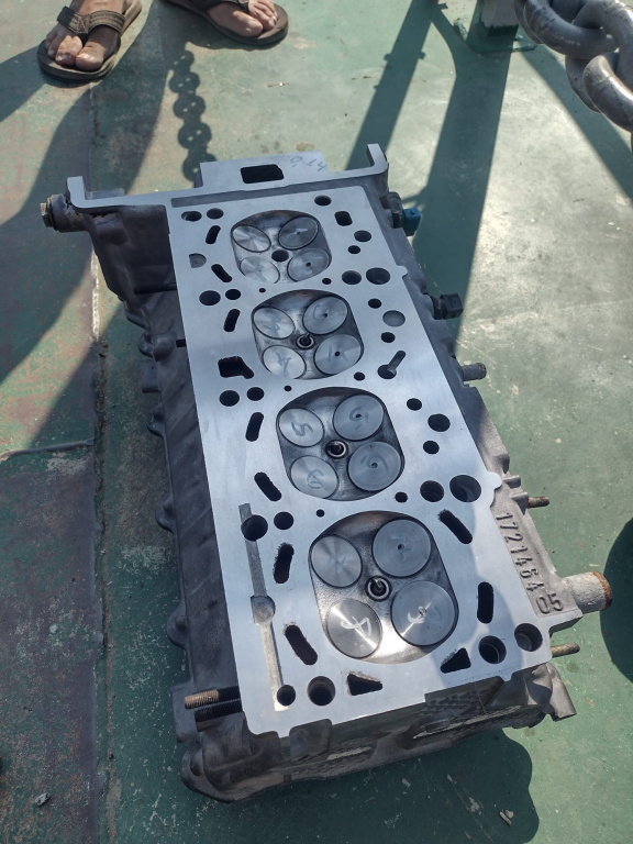

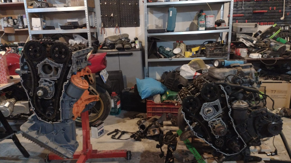

    Click image for larger version  Name:	set.jpg Views:	0 Size:	275.9 KB ID:	10087485 Click image for larger version  Name:	head.jpg Views:	5 Size:	204.3 KB ID:	10087486

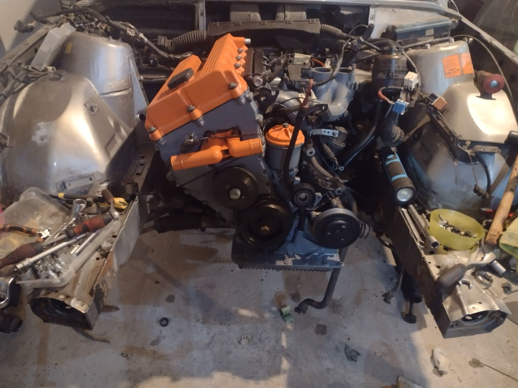

    Test fitting the M42 head and timing chain cover / oil pump on the reconditioned M40 block and oil pan:
    Click image for larger version  Name:	test it.jpg Views:	0 Size:	272.0 KB ID:	10087489

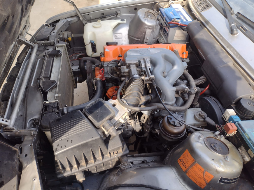

    Engine in the car:
    Click image for larger version  Name:	inma.jpg Views:	7 Size:	271.6 KB ID:	10087487 Click image for larger version  Name:	mot m.jpg Views:	7 Size:	212.8 KB ID:	10087488

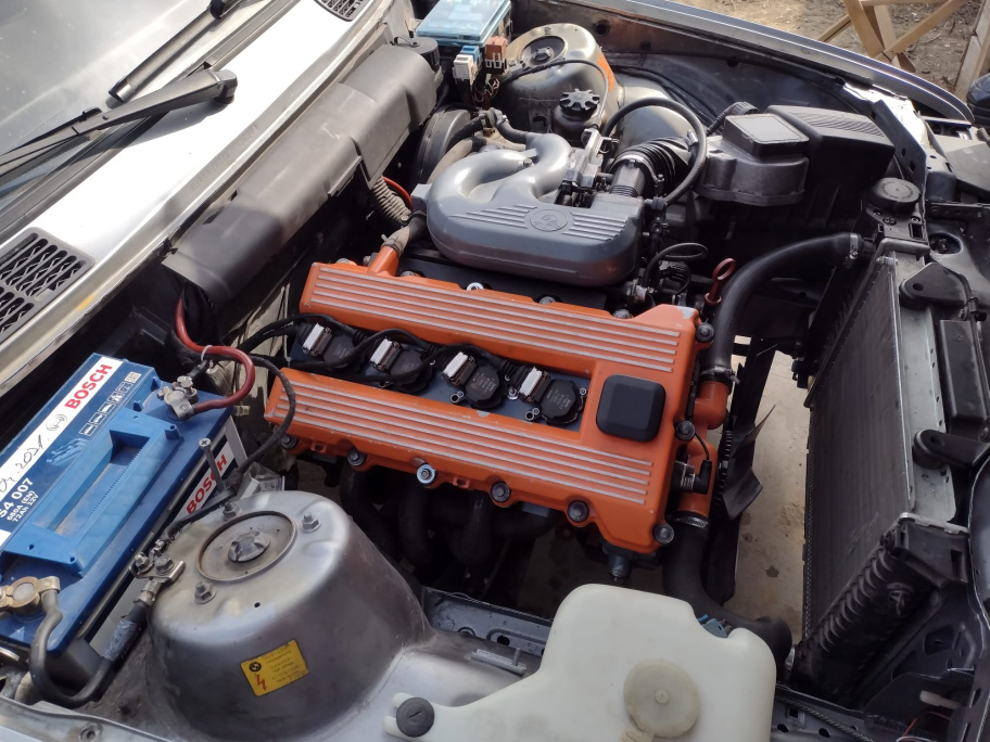

    Here's how my engine bay looks like right now:
Name:	coil over plug setup.jpg
Name:	finished engine bay.jpg

          Originally posted by bmwman91
          E30 M42's used Motronic 1.7 and did not have knock sensors. As noted above, the block has the bosses cast into it. The bosses should have untapped holes in them which may or may not need a quick pass with the appropriate drill bit before tapping. The front knock sensor is fairly easy to get at since it is just behind and to the right of the oil filter housing. The rear one is a little more work and requires you to remove the intake manifold and the big plastic wiring box which under it. You probably need to pull the heater coolant return hose out of the way too. Basically, the bosses are between cylinders 1+2 and 3+4.

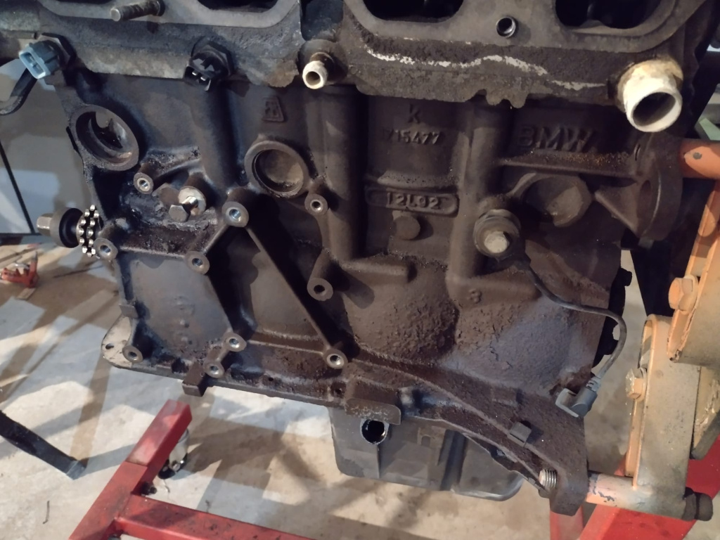

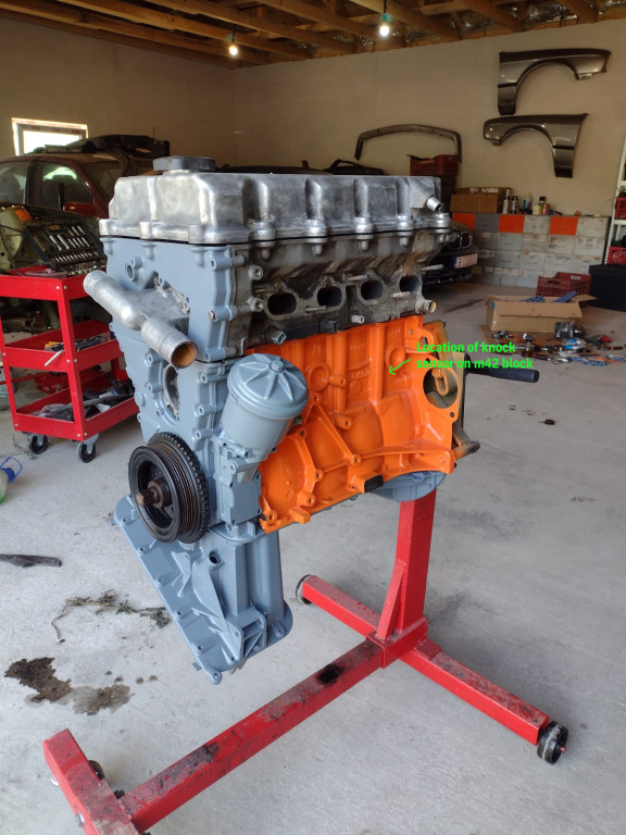

          Thank you for the input. I had a look at the engine I took out of my '92 318is e36 (which is now a 320i) and measured the depth, size and position of the bosses the knock sensors sit on.
          Click image for larger version  Name:	318is.jpg Views:	0 Size:	291.0 KB ID:	10087538
          Here are the two knock sensor bosses:
          Click image for larger version  Name:	318is 92 block.jpg Views:	0 Size:	262.9 KB ID:	10087539

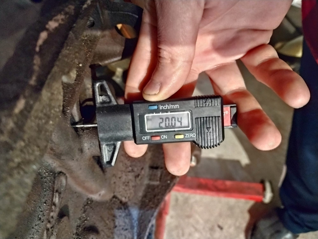

          They stick out the sides of water passages running between cylinders. The rear one is between the rear most freeze plug and a water passage, while the front one is inconveniently located between the top most engine mount point and the oil filter housing. They are 20mm in height (from the exterior of the engine block) and threaded for an 8mm bolt with a 13mm head. Thread depth is 18mm. In the pic above you can see the rear knock sensor (yes I know it's backwards, I had it off the engine and put it on just to take some photos and measurements). The front boss is the one with the 13mm bolt sticking out.
          Click image for larger version  Name:	depth.jpg Views:	0 Size:	253.7 KB ID:	10087542
          This is my M40 block:
          Click image for larger version  Name:	m40 block.jpg Views:	0 Size:	209.9 KB ID:	10087541
          As you can see, the bosses are completely missing. Therea are two flat spots on the block, you can see one of them in the pic above, similar in diameter to the bosses on the m42, but they're not in the correct location and are not nearly high enough. One of them is on cylinder 3 and the other on cylinder 1, behind the oil filter housing. On the M40 block they serve no purpose - they're probably marks left from the mold / casting process. They are 1.5-2mm in height and looking inside a spare m40b16 block they're about the thickness of the block + 2mm - not enough to drill into and tap. Interstingly they're also present on the M42 block - in the same exact location, with the rear on right under the casting number and the front one to the front of the knock sensor support, right next to it.
          So drilling is out. My only option would be to fabricate bosses out of nuts or spaces and weld them to the engine where the ones on the M42 block would be... that or have the DME software modified to ignore the knock sensors entirely.
          Welding onto the block would mean a lot of disassembly (oil filter housing, belts, alternator, intake manifold, starter) and draining the engine of oil - I'm not really willing to do it If I'm not certain it will yield any positive results as it's a lot of work....

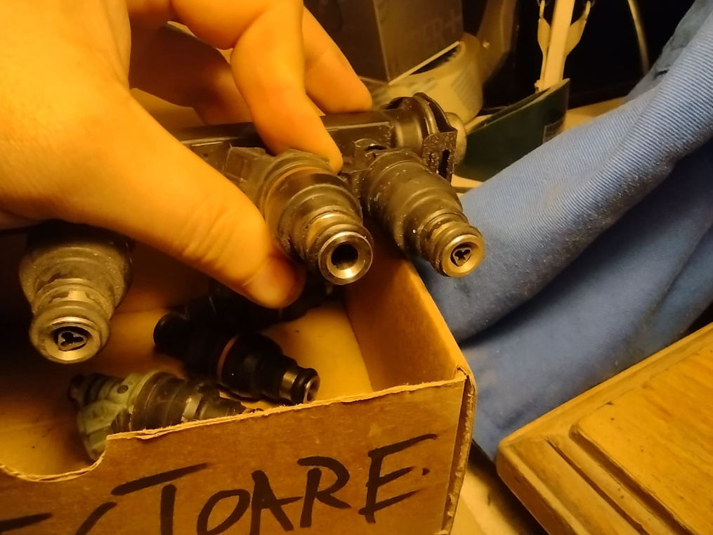

                  Oh yeah they've been sitting for a while - 3 years at least. And I can't remember witch engine they are off. Either a blown up late 96 M42 or an early 92 m42 with a cracked valve...

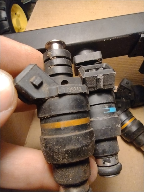

                  I've been rummaging around in my box'o'injectos and came across another set of M42 Lucas (I think) black top / orange line injectos, just like the ones I have installed right now. These have also been sitting for almost 2 years - and I also came across the odd, also M42 (I think), also Lucas black top / blue line fuel injectos I had on my M40 before I upgraded the engine to an M42. I had these blue line injectors in the M40 because I couldn't find replacement Bosch blue tops for my engine, and two of them were leaking externally (rusted case) so they had to be replaced. After installing the blue line Lucas in the M40 the engine changed significantly. I had to re-adjust the AFM to get the car to idle and it pulled all the way up to near-redline, something un-characteristic for an 8 valve M40, engines known for their mid-range and lazyness up top.
                  Looking around the interwebs I could not precisely identify the blue line injectors, but if they follow the BOSCH rating colors they'd be 21lb or 22.5lb, while the orange tops are 19lb. I believe the original bosch plastic blue tops that come in the M40B18 and the M20B25 are 17lb - but I don't think this is the case for the blue lines...
                  Black / orange line injectors part number: 173 9242
                  Black / blue line injectors part number: 173 1357
                  Here are some pics:
                  Click image for larger version  Name:	orange and blue.jpg Views:	0 Size:	156.6 KB ID:	10088047
                  ^Orange and blue line injectors side by side.
                  Click image for larger version  Name:	nozzles.jpg Views:	0 Size:	258.9 KB ID:	10088048
                  Notice the nozzles are different as well. The orange ones are open nozzle while the blue ones have a baffle plate of sorts, possibly to help with atomization.

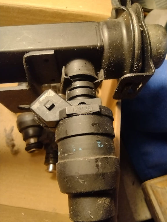

                  Click image for larger version  Name:	blue part nr.jpg Views:	0 Size:	142.4 KB ID:	10088046
                  This is the part number for the blue line injectors. Googling the part number did not yield any relevant specs.
                  ​The question now is - which ones do I install? I know the orange ones are stock for the M42, but they've been sitting for quite a bit and I don't know how well they run, as they might have come off a blown M42 or an M42 with a cracked intake valve that never ran OK. In contrast, the blue line injectors ran in my M40B18 for quite a bit - over a year - ran well, and seemed to increase that engines performance... but what are they off of? What specs?
                  What would you guys chose?
                  [UPDATE]
                  After adding the BOSCH specific 13 64 code in font of the blue top's part number I came across this page:
                  2023 BMW parts catalog 3' E36 318i Injection valve, Detail number 13641731357 (13 64 1731357) (bmw-etk.info)​​
                  Mystery solved, it seems the blue line injector are off a 1995 318i e36 with the M43B18 engine. Similar spec to the original blue tops in the M40B18 / M20B25, but in good condition as opposed to the rusty leaky ones I had before, witch is why I noticed a significant performance improvement.
                  Another site has specs:
                  Bosch 0280156346 / BMW 1731357 | INJECTOR PLANET CORP.​
                  It seems the blue line injectors are 15.4lb injectors, and the orange like ones are 19lb. Both made by Lucas.
                  This means if I want my M42 to perform properly I need to use the orange line injectors. I'm also considering finding a set of equivalent orange/yellow or maybe even purple plastic top BOSCH injectors, maybe of a 328... those are newer and more reliable, while having a similar spec. I don't know if they will fit the manifold properly - they should... The old M30 3 nozzle yellow tops fit perfectly, and I have a set of 6, but they are OLD... and have been sitting forever... they worked when I put them in storage, I used them on a heavily modded M20B27 (323i 713 code shaved head with larger valves and 2.5L cams, b25 intake and throttle body, megasquirt) with great results, but that was back in 2008 or so.
