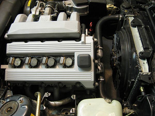

          this is why I like the volvo fans, nice clean tight fit
          you will also want to run a different thermo switch, it kicks on cooler
          80°/88° Dual Temp Switch: 61-31-8-361-787
          and to be honest, this is not my set up, I am however running an idetical set up using the fan and shroud from a 960 volvo that i PAID $45 FOR. I am also running the cop kit like shown, no a/c and no p/s ( mine looks little different, I cut off the coil brackets, painted black valve cover and strut bar corss brace and skid shield, because of the skid shield in place it does not show the space contrast as nice as this picture did/does as instead of seeing the floor in this pic in mine you would see big black plate and mine is dissassmebled as I am wiating for timing chain parts)
          when you use the stock wiring, and if you do the a/c delete you actually still have the wiring and if your sitting in traffic and you want to kick on the fan before the thermostat does, then yuo just hit the a/c button which would have normally turned on the fromt elec fan with the compressor, now it will just kick on the new fan, it also acts as a nice bypass if you suggest your temp sender not working

            ^The m44 fan does take up substantially more room up front, but pull the two plastic pins/unplug the harness connector and it easily lifts out for even MORE working space than you have there.

              yep mine (the volvo style) is a bit more work, takes 4 screws and the stock harness plug and then lifts off
              but it does take a little more modify work at first install (more than the bmw one)
              but they both look slick and get rid of that clutch and fan and I would install either style if I had to do it again.
              so a lot depends on whats available and desired looks
              Ryans write up on the BMW install is very good

                also, Id like to point out, that the bmw housing will actually allow more air to flow (in my opinion) as the volvo one sits tight and actually has a small sectin of flat plastic against the radiator that blocks air flow where as the bmw allows air flow over the whole radiator and acts as a big funnel
                plus it is "BMW"
                but Im not gonna pull my volvo one untill its dead
                one last thing, the bmw ones are newer, the volvo ones that fit best are getting harder to find due to age
                again, nice write up on ryans
