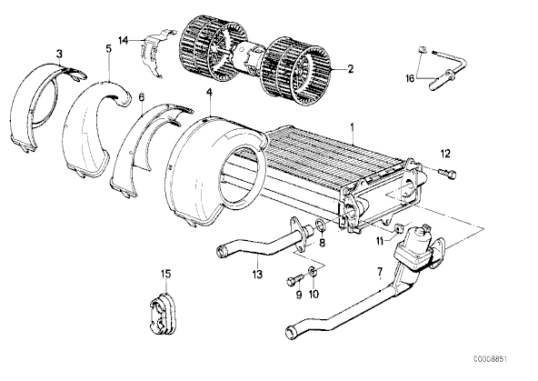

        im starting to lean toward heater valve but haveno idea where it is
        • Ryann
          • 3350
          #7.
          http://realoem.com/bmw/partgrp.do?mo...18&hg=64&fg=15
          • Ryann
            • 3350
            Found it with r3v search. :)
