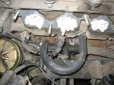

    found leak here
    sorry for the funny looking pic. i had used my camera but couldnt find the usb and so had to take a picture with my phone of a picture :]
    any idea where the coolant could be coming from?

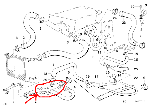

          The area here in red shows the piping that fits into the block. Check all your hoses down there while your at it. If you know anything about the "mess under the intake" it might be a good idea to get rid of the throttle body heating plate and all the random hoses not needed.

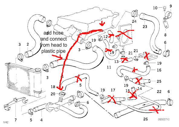

                              lol okay. a shit ton goes away. everything with a red x throw away. :)
