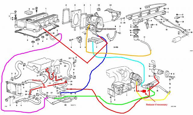

    so i removed the "mess under intake" but one of my fuel lines broke and i didnt realize this until the fpr had a broken little hose connected to it. where exactly does it go?
    • Gerta
      • Sep 2009
      • 2119
      #32
      Randy, it goes under the intake manifold and connects to the throttle body.
      Parts Collector and Former Houndstooth interior junkie.
      • Gerta
        • Sep 2009
        • 2119
        #33
        Randy,
        Here's the diagram of where those connect:
