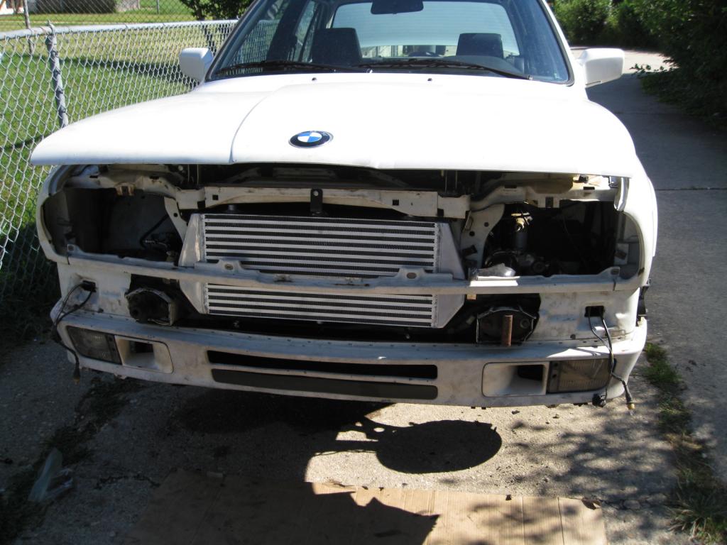

                    So a question a bit off the beaten path, with the caveat that I'll be strongly considering buying your kit next winter once the race season is over and I have some play money:
                    With this being a rallycross car, I have pretty limited interest in having a low-mounted FMIC. It would get limited air anyhow since I have a large skidplate, I'm thinking, but more importantly there is a big possibility of damage to it. Not sure how large the FMIC is exactly, but what about the possibility of a TMIC mounted (more or less) above/behind the radiator (over the fan, which on mine is a Spal electric). I already happen to have a large opening cut in the hood there anyhow (for general cooling) and could add a low-profile scoop a la Subaru Legacy. I guess my question is whether this would be a reasonable place to mount a TMIC, and/or what is the possibility that it would actually fit (including piping)?
                    Just curious. :)

                      I don't think there would be much room there to fit an intercooler. You might have to cut a HUGE hole to make it work

                        The intercooler is not that low, really. The bottom of it is basically flush with the bottom of the bumper.

                        I'm sure with a little more creative piping you could get one just behind the kidneys, especially if you get rid of the high beams.

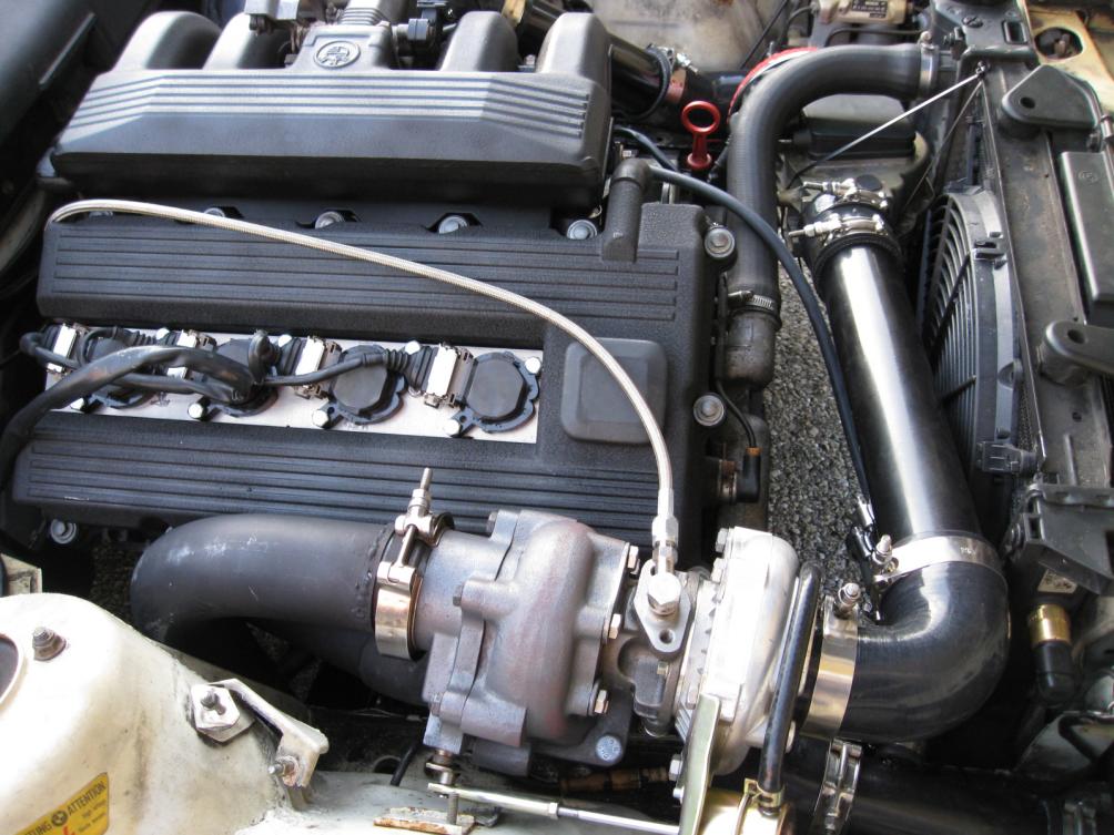

                        The main problem with relocating things in the engine bay is the requirement to use the stock AFM. There is just no where to put it on the passenger side of the engine bay, so it has to make it's way across the front of the engine.

                        If that piping wasn't there, I think there would totally be room for a long intercooler in that space (which would also look badass with the scoop). You might be able to rotate the turbo so the outlet came above the intake, but then you would run into hood clearance issues.
                        Or you could just do what these guys did and move the radiator back. Vidya But then you run into AFM routing issues again.
                        Basically, if you go standalone engine management, you have a lot more options.
                          Really, a water to air setup would be perfect, and it would squeeze right in there.
