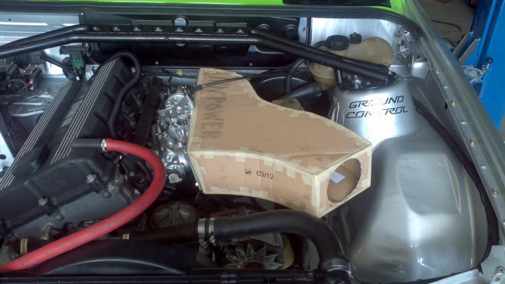

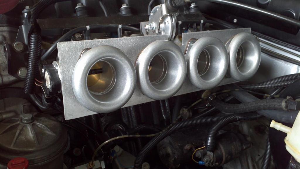

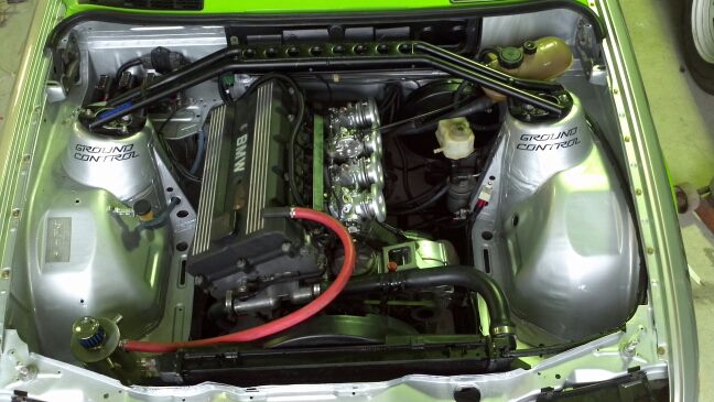

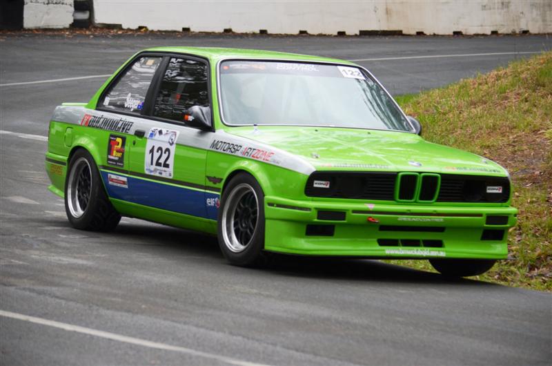

Hi all, I have just joined R3Vlimited and thought i would share with you my current project. I have been running my E30 318i track car for a few years now with my fairly stock M10. Only mods were the removal of the water pump, pod filter, exhaust and a MoTeC m800 ecu. Pic of old engine below

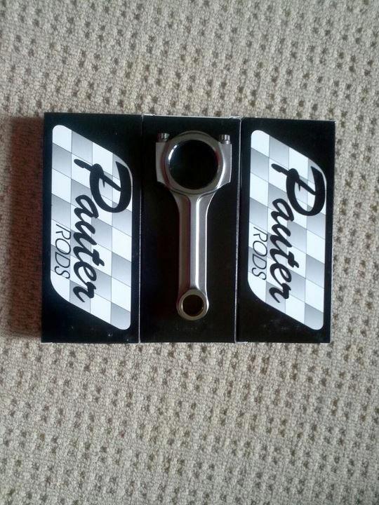

I have now nearly finished my build and install of the new M42. It features forged Pauter rods

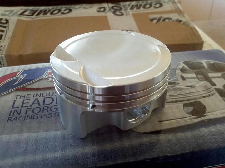

+1mm JE light weight 11.0:1 pistons with Total seal rings

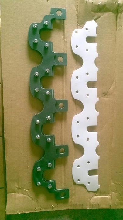

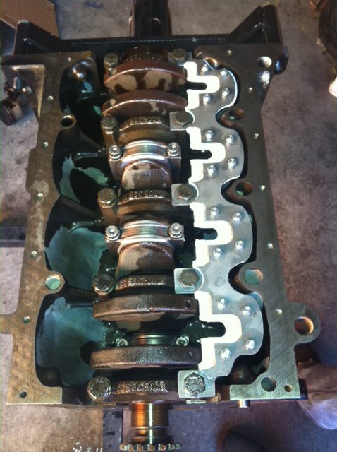

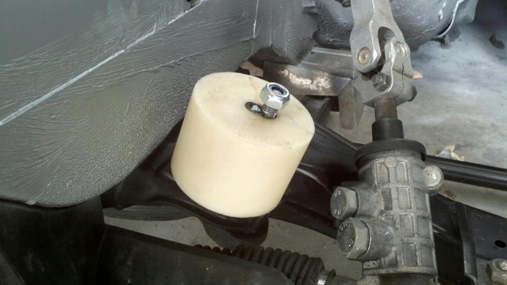

teflon edged Crank Scraper
