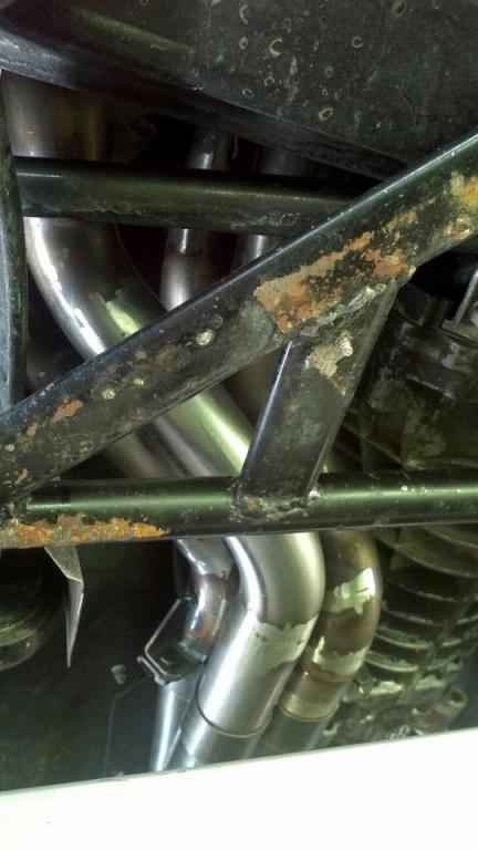

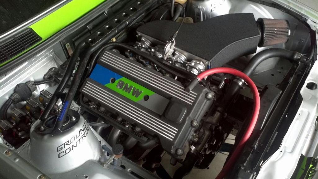

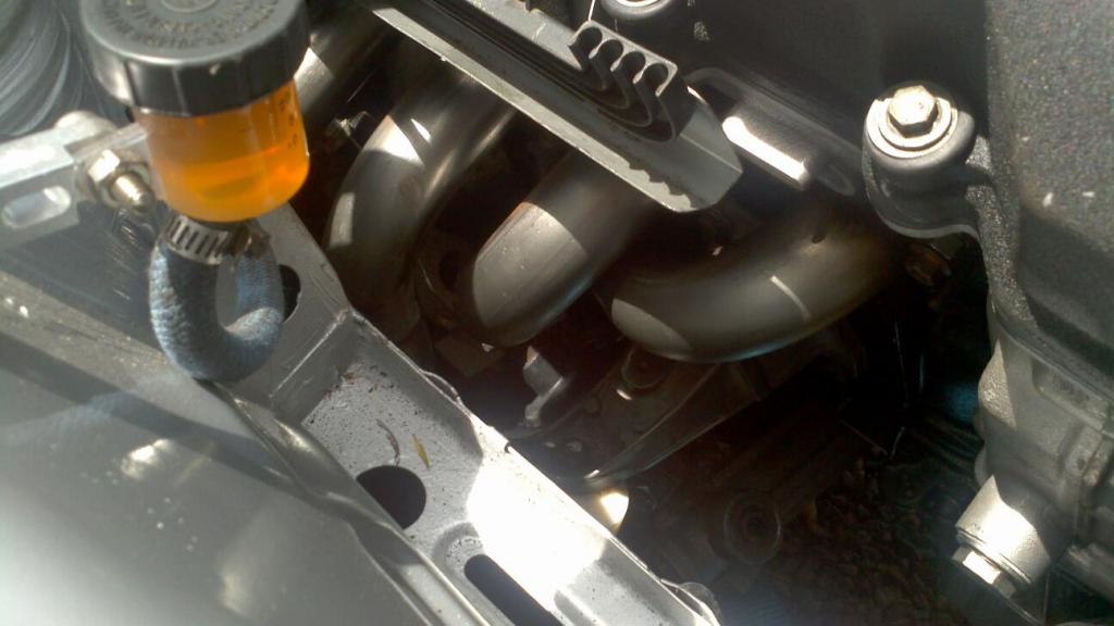

        #33

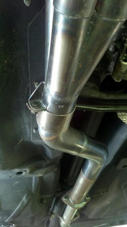

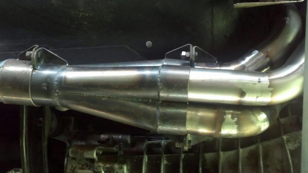

        Had my headers made, chose a 4 into 1 setup.

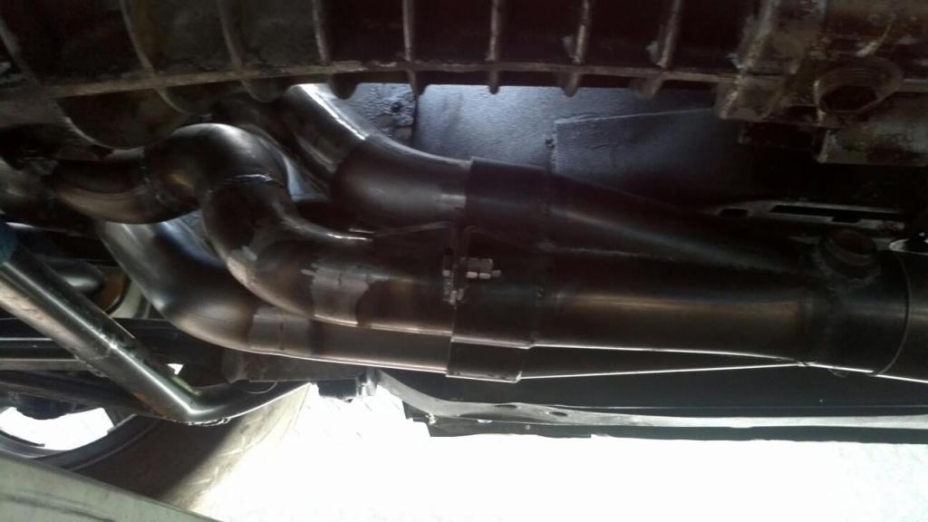

          #34

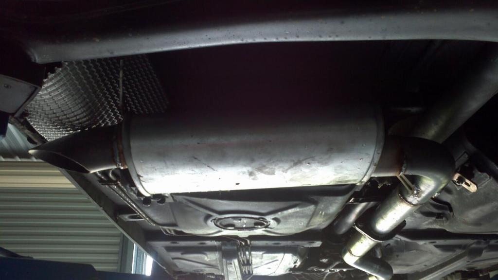

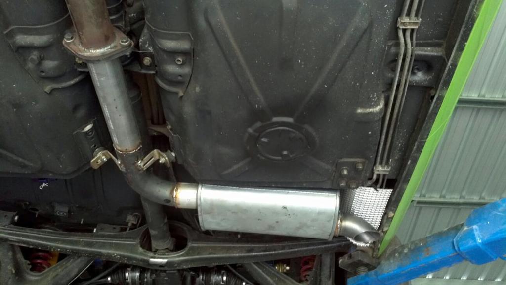

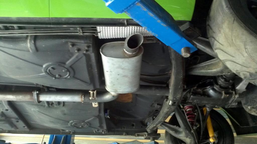

          I also made my side exit exhaust today

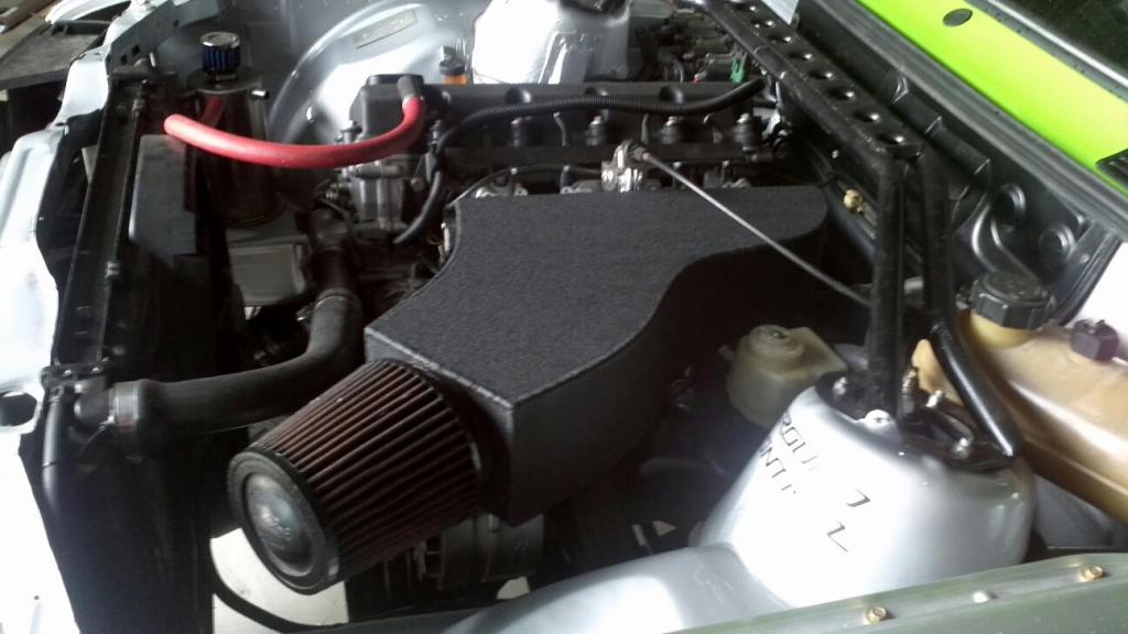

            #35

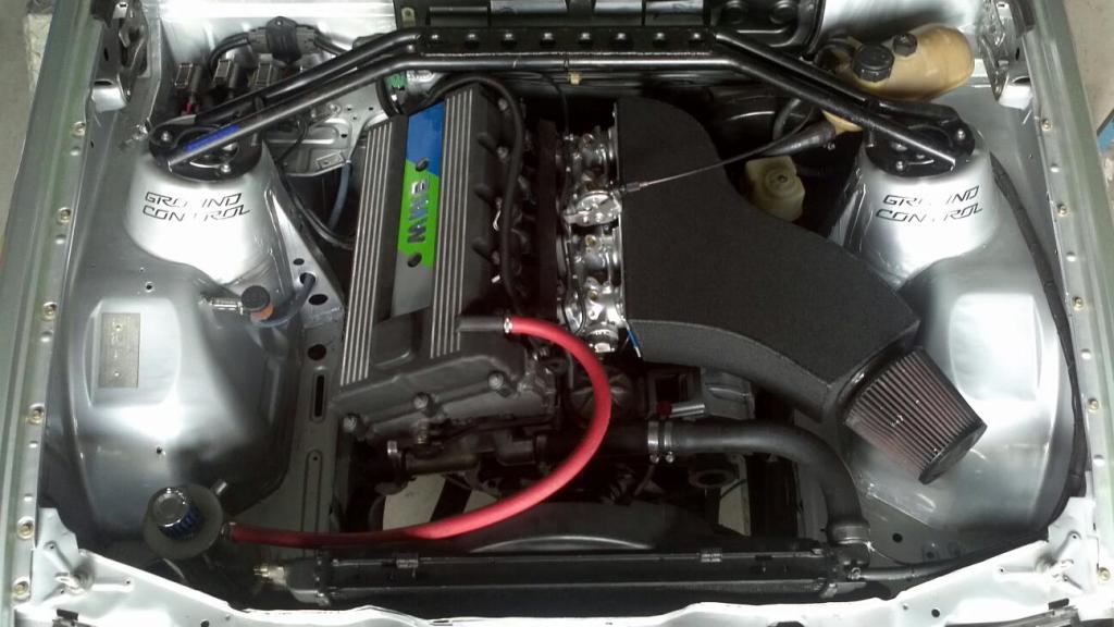

            Now a shot with the air intake fitted.

                I live in Hervey Bay, Old. Yes he will make more but he will need your car. I actually had another set made for a friend. The cost $500 a set

                  Those headers are shit-hot.

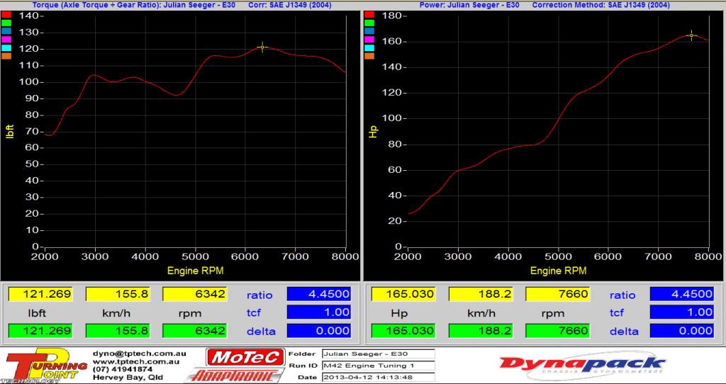

                          #42
                          Dyno tune done
                          Well she made 165RWHP @ 7660 RPM. Here is a couple of links to you tube of it on the dyno and a pic of the dyno result.

                            #43
                            Wow- nice numbers!
                            Any idea what that hole at 4750 rpm's about? Might be a bit low to worry about,
                            but, as they say, torque wins races...
                            t
                            • joolz635
                              • Mar 2013
                              • 97
                              #44
                              Yeah its turbulence created by the ITB's. I can't wait to see how it goes on the track on Friday.

                                #45
                                hey nice build. i particularly like the airbox and i'm attempting to do something similar on my M20
                                what size primary and secondary on those headers? what size throttles and inlet runners are the dbilas? For the M20 they are over the top maybe the same for the M42?
