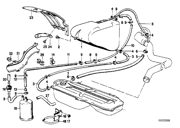

                          thread back from the dead. I have everything ready to come out. My biggest concern is fuel. Anyone have any idea if I will have to change fuel pumps? What about fuel lines? Is that charcoal cannister necessary? I don't think the m10 fuel system has a third line.
                          • FredK
                            • 14745
                            Yes, I think the M10 318i only had two fuel lines running to the front of the car, but they did have provisions for fuel expansion according to the ETK (realoem.com). I'm not sure where, but the car had a charcoal canister and expansion tank.
                            So, you shouldn't need to install the M42's charcoal canister. However, that leaves the issue of the electric valve that the DME will likely want to see, otherwise it will store an EVAP code. I believe the solution is to plug in the valve, let the hose dangle off the throttle body, but plug in some kind of small filter on the opposite side of the valve.
                            That leaves the issue of the pump. I don't think it'll matter too much. I mean, you're blowing 90 to 100 psi on two cylinders. You need to lean out the mixture anyway. HAHAHAHAHA.
                            HA.
                            HA.
                            HA.
                            No but seriously, I think the m10 fuel system is fine. It's the two pump system, right? There's an in-tank pre-pump and a main pump, the same system as the 325e. So, it should be fine.
