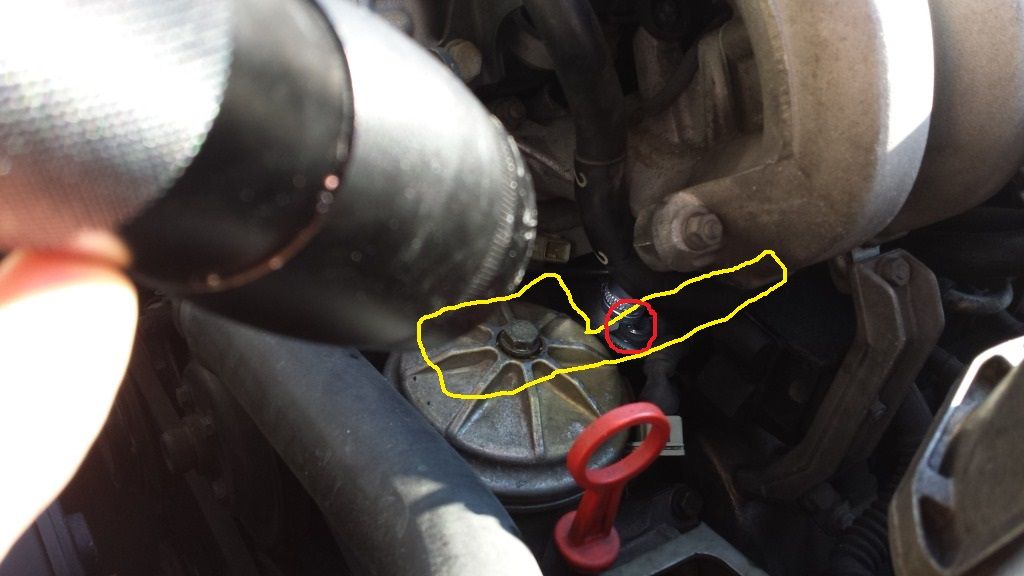

    This hose broke..
    The red circle shows the actual damage.
    The yellow outline shows the hose that needs to be replaced.

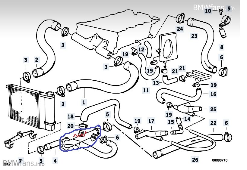

    I think the hose is #4 in the diagram below but i'm not sure because there is no direct number that shows up next to the part I circled. (The red zigzag line shows where the damage happened.)
    Any DIY's I can reference to get to this hose? Also, If you can verify the part number of the hose I need, I'd really appreciate it.

            Anyone know the part number that I need to order?
            Also, can anyone tell, from the lame picture that I posted above, if my "mess under the intake" is still there?

              Make SURE that you buy the genuine BMW water pipe that costs a few dollars more. The 3rd party ones do not fit and are notorious for leaking/cracking.
              http://www.pelicanparts.com/cgi-bin/...3-1-714-738-M9
              You probably also need to buy the rubber O-ring for it, 11-53-1-709-157.

                Yes, the mess remains in the pic, but cannot see if there are heater plates.
                As was said above, get the BMW water pipe not aftermarket.

                  Amusingly, a few years back, the BMW pipe was wrong, and some of the aftermarket
                  was right.
                  So just check what you get and make sure it fits right. If it doesn't, file the
                  bolt holes until it does.
                  Not too hard.
