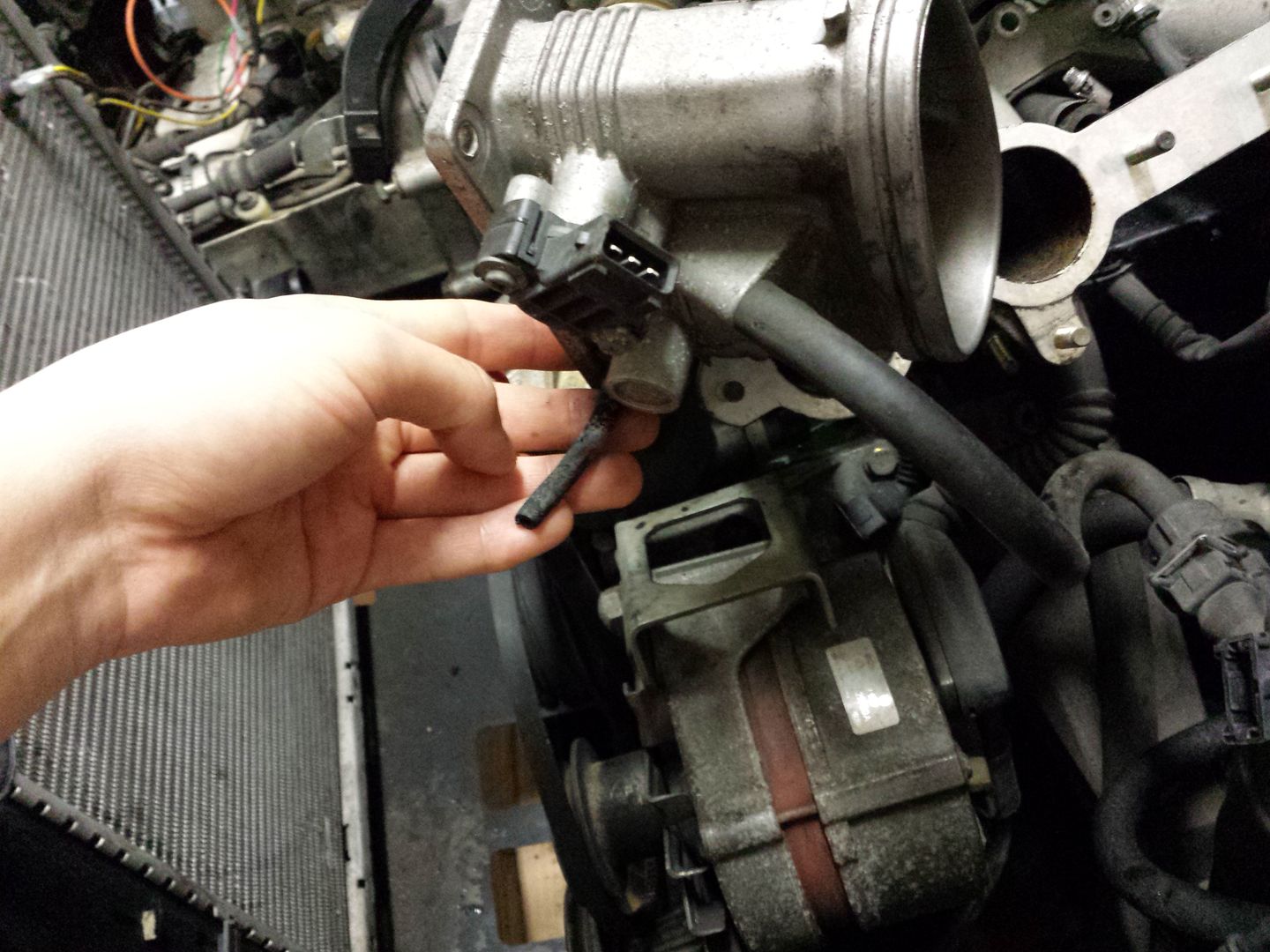

    Throttle body hose part number or inner/outer diameter?
    Anyone know the part number or the correct inner/outer diameter size of this hose that comes off of the throttle body? I'm referring to the little hose by my fingers. I am guessing it is a vacuum hose?
    I accidentally ripped it into two pieces... it looks like it was on its way out anyway so need to replace..
    Thanks in advance yall.

    that would be your fuel pressure regulator vacuum hose. It is 1/8th inch diameter tubing.

      gracias. For anyone interested, I did find the part number.. 11727545323

        It's just regular vacuum hose, nothing special, so you can get it at any auto parts store.

          I've been using this site, to figure out where things go and part numbers for things that need replacement.
          Part groups | BMW 3' E30 318is M42 USA — BMW 3' E30, 2-doors identification USA 318is (M42) — 318is (M42) — USA — BMW 3' E30, 2-doors — BMW Parts Catalog

              Simple vacuum hose until you find out that your local shops only stock standard sizes. Too big and it'll leak a little or too small and it'll split after a while. Try to get metric if you can. I bought about 6ft of the braided stuff from ECS tuning a while back and have found all sorts of uses for it. :)

                Buttchug mentioned its eighth of an inch diameter vacuum hose..
