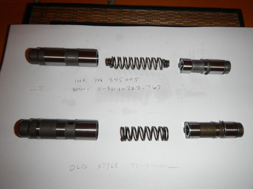

    BMWman, I just posted my findings and then saw you had posted. I immediately pulled my new tensioner out of the box and confirmed. All my numbers are moot because they are based on the old style tensioner. I guess I'll be looking at changing out a few tensioners here in the near future. Don't forget to order a new crush washer for the tensioner.
    • bmwman91
      • Oct 2004
      • 3134
      OK, makes perfect sense. I think that the reason for the design update was related to the fact that it would "stick". Thanks for taking the time to detail all of this!

        Ok, I need some help here. Everyone writes about popping out the piston, but how? Earlier post mentioned having it in a vise, but how do you do it without scoring the machined sections, and with what do you pop it out? There's great pictures above of it being apart, but not how it got that way. Can someone post a picture about that? I've looked around the forum but haven't found one. I'd like to install mine this weekend.
        Thanks guys/gals!!

          Assuming you have a new one, to get it to extend you just need to push on it to compress it a little, and it should release. I recommend pushing down on it onto a table or something, and slowly letting up on it so it does not spring apart. It shouldn't pop all the way apart, but it can (and has in my case).
          To get it all the way apart, you can wrap it in a rag and put it in a vise, and then pull hard. There is NO reason to do that though, unless you just want to look at what's inside or something. Don't lose the spring!
