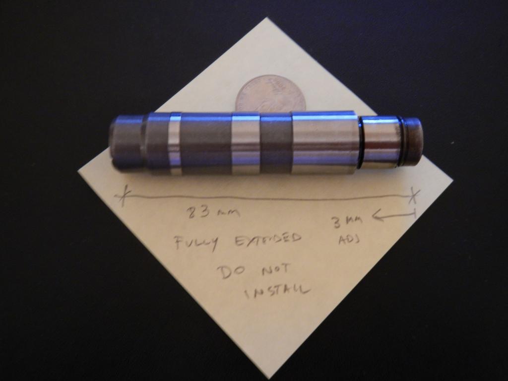

                      A fully extended tensioner before you get ready to break it down is 83mm in length. Once it extends that far it locks itself and will only allow 3mm of compression travel. This is why I say do not install it extended. After 3mm it essentially becomes a solid rod as you continue to turn that endcap and force that rail onto the chain. The novice wrencher most likely won't differentiate an extended/fully extended tensioner.

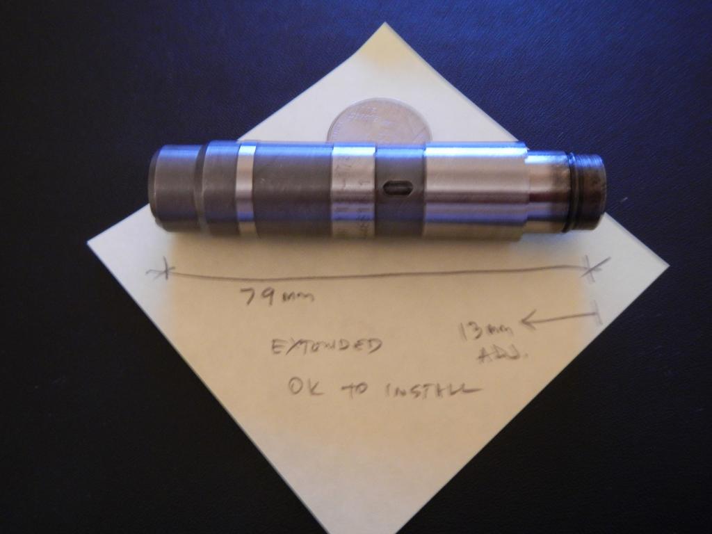

                      A tensioner with the clip in the last groove is 79mm and allows the piston to travel 13mm when you compress it. This is the "extended" tensioner that everyone alludes to.
                      Based on the piston wear marks, this tensioner operated in the 75mm range.

                        I don't understand what you're trying to say. The very first time I installed a new tensioner I put it in and pushed it on the inside to make sure installing it extended didn't jam the tensioner and no problems. Never heard of anyone having an issues installing it extended.

                          Interesting. I see what you mean now, thanks for the details. So popping it open to 79mm is not a problem, but if one were to pop it past that to 83mm then they are going to have an issue? Whenever I install one I have always popped it and then made sure that it travels smoothly by hand-squeezing it. I assume that if it was opened to 83mm, screwing the cap back on would probably feel very tight before it makes it to the fully-seated position since it would be stuck open?
                          How does one get it to pop out to 83mm? I can't recall ever getting it to open that far. If you do pop it that far, how do you put it back to the right length?

                              A few months ago I installed a fully extended tensioner on a 318ic and was able to seat the endcap. I was not able to move the rail when I pushed on it and the chain tension was ridiculous. More than what I had seen on my 318is, my E30M30 and the few M5x's I have worked on. The endcap was very tight going in which kinda raised a flag. Maybe the motor only having 150k miles has something to do with it, newer rails? Stopped work, then did it according to the Bentley, no issues with the car. Don't recall why I attempted to install it extended that day.
                              Did some more experimenting.
                              Starting with a compressed tensioner - 68mm
                              The initial push on the pistion will get it to expand all the way to 83mm.
                              tapping the back of the tensioner with a hammer will get it to come apart so you can begen the process of compressing it back to 68mm.
                              **I attempted to just open it to 79mm but was unable to do so, every attempt from 68mm had it going to the full 83mm length.
                              **I attempted to get the tensioner to expand from 79mm to 83mm but was unable to do so by rapping on it with a hammer. This refutes my note in the picture, in the previous post about installing it at 79mm.
                              **With the tensioner in the vise I expanded the tensioner, I had the full range of travel and was able to move the piston freely from 68mm up to 82mm and go from 82mm back to 68mm. Once expanded to 83mm the clip set and then I was only able to compress it back to 80mm.
                              Because it locks once fully extended it has to be broken down in order to reassemble and compress it. On reassembly, center the protruding clip as you dog down on the vice/C-clamp and the piston will go in. The clip will catch at the 79mm mark and if you back out on the vise it will hold together. Continue to compress it and the clip will catch again at 68mm.
                              If installed according to the Bentley, you get the full travel of the piston with it locking only after it hits full expansion. I would assume if you get to full expansion then some/all your timing components are worn. Installing it fully extended only gives you 3mm of adjustment but if that's where it currently needs to be then it's not an issue because it's doing it's job taking up the slack. I just don't see running it at the upper limit when you have a nice meaty range in the middle.
