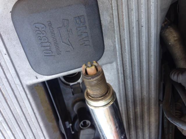

                        Checked for spark and there was nothing. had the battery charged and its at 100%, fusible link is good, i can hear the starter "click" when i turn the ignition "ON". i can hear the Main Relay click when i turn the ignition "ON" and stomp test has shown 1444 before and after the battery was removed and charged.
                        when i pulled the spark plugs they are yellowish in color, and i could not smell the presence of fuel. i also removed the small hose from the FPR and attempted to start the car to see if any fuel would come out and there was nothing.
                        this is what the spark plugs look like. this cylinder #1:
