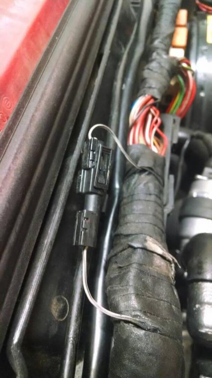

    What is this wire for?
    Was replacing the blower fan and noticed this wire was unplugged. I connected it back and it didn't seem to make any difference. So now I'm wondering what its for. See attached pic. Click image for larger version

    Unplug it. It is for m42's that don't have a catalytic converter.

      That was quick. Thank you!!!

        Yup, you don't want that connected.

            What exactly happens with it connected? I only had my engine running for a minute or so with it connected but I didn't notice anything different

              Results in starting and rough running issues, especially with restarts after the engine has been run for a while/warmed up.

                  Read this, went to to my car at 2 AM, "yup it's plugged in." Unplugged it and it seems to idle a bit smoother now. Gonna have to drive it for a while to see how big of a difference it makes.
                  I've never heard of this wire till just now and you guys saved me a lot of trouble. Seriously, thank you.

                    I knew this topic would be about this wire / plug...
                    Everything has been said, I will just add this picture, check bottom left

                      Ditto. I knew from the title what the OP was talking about before seeing the pic.

                            CUT THE RED WIRE!!!
                            The most classic M42 question. When in doubt, pull it out.
