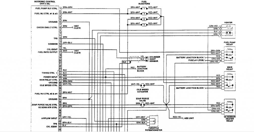

                      Update
                      Did continuity test, no signal from tps. Unplug tps car revs fine, cam sensor and crank sensor continuity tested fine.
                      Now I have a cel light even with the sensor plugged in but she will rev up. The tps sensor is a 3 wire however there is only one input on the ecu, need to trace wire and bypass now.

                      • varg
                        Florida Turbo Man
                        • May 2014
                        • 3423
                        So no continuity between pin 12 of the ECU connector and pin 2 on the TPS? From my reference, which is a little easier to read than that, the 3 pins are 1: +5V, 2: Signal, 3: Ground. Sensor ground on the ECU is pin 43, +5V is pin 59.

                          Yes issue was between pin 12 on the issue and pin 2 on tps.
                          Fixed it last night, now I just have to finish the rest of the car.
