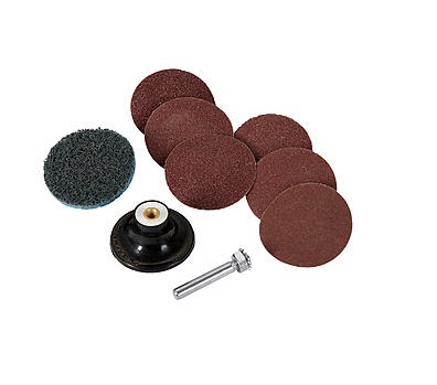

      Get yourself a set of sanding/abrasive discs

          Great input everyone. I love the idea of abrasive disks with my wrench or air drill. That would clean it up well.
          Its a used clutch, so Ill save the machining for the Single mass pickup or new clutch. Plus, Ive droppd this trans and engine more times this year than Ive installed a clutch in my life.

            Used pressure plate and flywheel and friction disc?
            Don't touch it- if it was working before, it will continue to work.
            New friction- LIGHT scuff. The discs above, used carefully, will do that.
            Used carelessly, they will gouge the surface, and make the clutch grabby AND more
            prone to slip.
