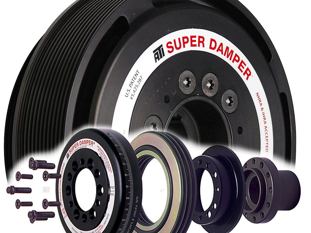

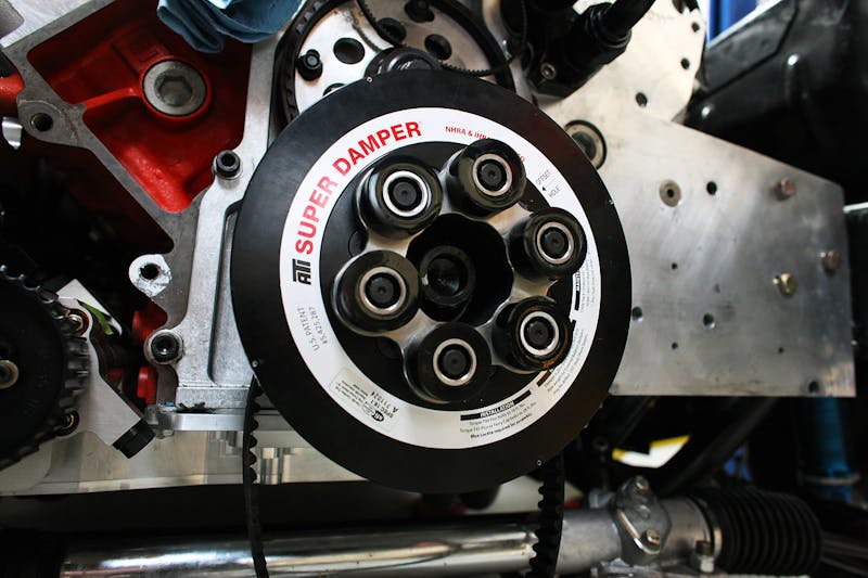

    If the dampers are hard to get in good shape I would just get one from a company like ATI. They don’t have an OTS version, but its easy enough to adapt the damper they build to a custom hub. This is what the VAC kits, etc. are. There are hub specs available for a lot of other BMW engines so I would be surprised if one already on the books wont work.
    I got your PM, just have not had time to respond.
    Speaking of ATI you might find this interesting:
    J.C. Beattie, Jr. of ATI Performance offers tips and advice on damper selection and addressing vibration issues.
    When you need a custom or trick damper for your race car or street/strip machine, ATI has custom solutions that can reduce weight, clutter, and total number of parts, and perhaps improve overall engine output and increase engine longevity.
