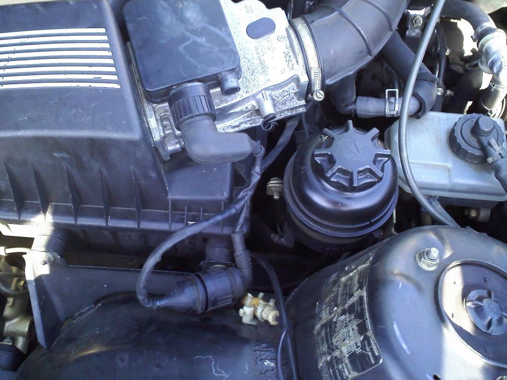

            this problem has been solved, it has to do with a sensor for the catalytic converter, in Europe they don't have one so this once sensor is not plugged in, in the US we have cats so the sensor needs to be unplugged
            Please see my thread on M42 club
            And here is a picture to help you locate the plug.
            Please excuse my MS Paint drawing, it was quick, and I did it a long time ago.
                Read the thread, he has said multiple times that he has done this and this isn't the problem.

                    I watched the videos, and if I still had my 318 I would plug the sensor back in and take a video.
                    That is exactly what mine did, down to the rpm range, the time frame and how it sounded...the thread over on m42, other people it didn't work for, but the vast majority it was a fix.
                    good luck to you.

                      It's just a case by case basis, I bet i might work on someone else's but I have located and unplugged it, unfortunatley not the solution.
