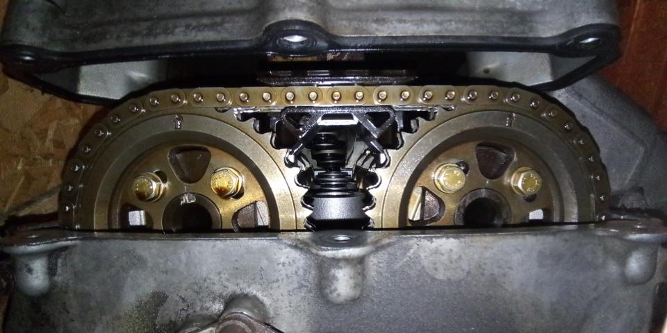

      1. Is that the black and white hot start cable I've read about on these forums?
      2. Here's a picture of the timing gears:

        1. Single pin connector, passenger side, under the cover mounted on the firewall
        2. Those are beyond salvation, or at least the pic seems to show them that way, and I seriously doubt if any of the timing system on that car has been serviced
        3. Yes, but do the entire system, not just refrigerant
        4. Single mass is probably single mass, doubtful if it's proprietary
        5. Spend nothing on an unknown quantity, especially if it's as neglected as the gears show. At least do a compression test before buying parts

          The guy did a compression test for me before I bought it and the numbers were nice and high, so I knew it was good in that aspect, however if I had known that the timing system was in this rough of shape I probably would have reconsidered. I'm trying to learn more about this engine and E30's in general but I suppose I should have done more research before diving in haha, thanks for the help though

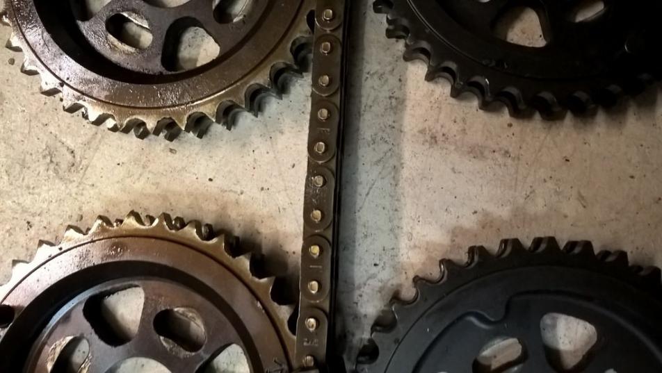

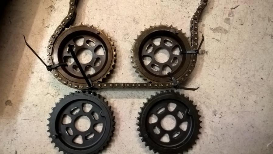

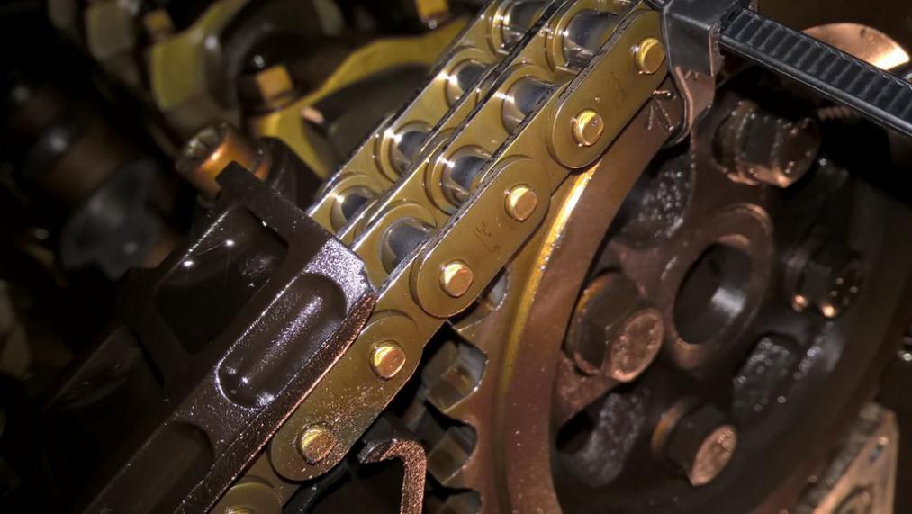

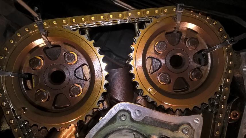

            there were two type of timing gears, that engine has the early, pointy style gears. the later squared style are different, but that doesn't mean the pointy ones are bad. As I read on a cycling forum the gear and chain wear together so I replaced the gears when I bought a new chain but there was no evidence that the original gears on mine were worn. The guides did show wear.

            • arrayxt
              • Oct 2019
              • 18
              Well, considering you're saying your old gears weren't really worn in comparison to the new ones, mine don't look much different than yours did so I definitely wouldn't doubt that my guides are worn and whatnot. I'm going to take the whole timing cover off and have a look at the condition of everything likely tomorrow.

                • 7830
                Both of your old gears seem to exhibit chipping, uneven base notch wear, and that seems to say that there was an issue with tension or link spacing at some point. However, even the loss of a full tooth probably wouldn't impact operation at all on a dual row chain, providing timing is centered on both gears.
