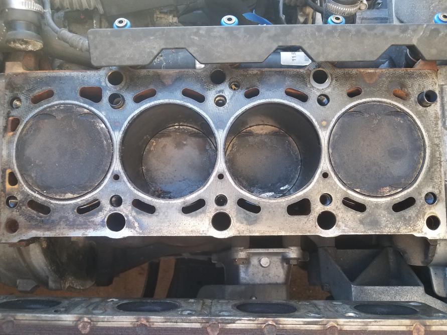

ID:	9939386 Hi all, I'm in the middle of a headgasket job and being my first, I wanted to ask some of the seasoned wrenchers how the block looks and if I can go ahead and slap the gasket on. The build is just a normal daily.
    Sorry, I'm posting for a first time in awhile and cant sort pics. Top is the finished, using a green pad. Though I thought I was being careful, vacuuming while scrubbing a lot of debris made it down the piston, as they clung to the side of the walls. I spun the cranks over several times to finally wipe away all debris.
    the other pic is when I pulled the head, gasket came off with little effort and no noticeable HG failure that my armature eyes could tell. The other pic is the first round of cleaning with plastic scrappers.
    the head was sent to a machine shop and no cracks were found, pressure tested and valve cleaned.

    Here is a close up of the cylinder closest to the firewall. As you can see there is clearly an outline of previous gasket but its below the surface, I wont be able to remove without removing material. At this point, I'm hoping it's good enough. Thoughts?

      is it flat? does a razor blade grab any material? did you scrub with a chemical cleaner and non absraive scourer? stains are ok but you shouldnt be able to feel any irregularities

        A razor glides right over. I started with acetone and finished with brake cleaner. Running a white microfiber barely picks up any dirt.

          Looks good to me , Stains are ok but nothing else!!

            Run it, it'll be fine

              Looks good to me. If you're still paranoid, you could maybe spray the HG down with some copper gasket spray before install. Sent from my moto g(6) using Tapatalk

                Thanks for all the input, I'll run with it.
