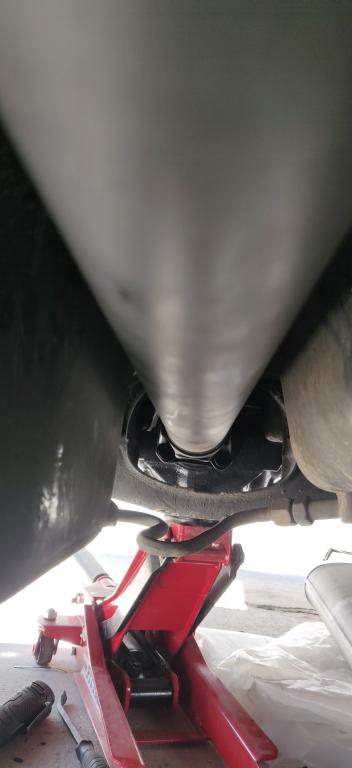

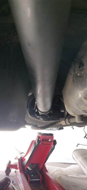

    Hi everyone,
    I have a 1991 318i sedan (m42) I recently replaced my diff to (4.10 medium case LSD) and serviced the manual transmission and did the 5 lug swap and changed the center support bearing for the driveshaft
    now when I am driving it I have a vibration that starts when I hit 70 mph and higher (more speed more vibration ) the worse at 80 mph and when I turn there is a clicking noise in the rear driver side !!
    decided to take the driveshaft apart to check the alignment marks and it is aligned according to the manufacture white dots / it use to drive smooth before doing all this work :(

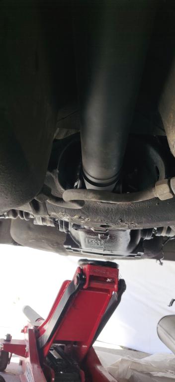

    I noticed that the diff is sitting to the right of the subframe (passenger side) is that normal? and anything that I need to check while I have everything disassembled to check for the vibration?
    I attached some photos showing the driveshaft

    Did you bias the CSB forward 5mm as required by the service manual? The rubber web needs some pre-load to function as intended.
    As far as the diff seeming to be offset, I am not sure since I don't have a medium case diff installed.
    Since you did a 5 lug conversion, are you running used wheels? It could very well be that one or more of them is bent or unbalanced, or something is up with the tires if they are also pre-used. Getting a wheel straightened is fairly inexpensive.

          I have had bent flanges on diffs do that-
          it imbalances the driveshaft, and gives all sorts of awful driveline vibrations.
          Easy to check- pull the driveshaft, and run a dial indicator on the machined surface.
          There should be 0.00mm of runout. Usually, you'll see a 'divot' or a bent ear if this has happened.
          If the diff gets dropped on its flange, they bend pretty easily.
          I've also had loose pinion bearings manifest as a vibration, too, as
          that causes a similar imbalance. There should be just a little
          preload on the bearings when you turn the pinion.

                    I looked through some old pictures of my diff when I had it out, and the input flange is definitely offset a bit to the left (if you are looking at the flange). Your diff should be positioned fine...if it was so messed up that the input shaft was out of place, it would be obvious I think.

                      yea exactly i found some photos online showing that the diff is offset to the passenger side so i know now that is not a problem. for the CV axles i did rebuilt them myself I paid crazy attention to details which I didn't have to but I did anyways to the point that i took ton on photos and put every single component in a separate container and did one axle at a time changed the boots and used (Red Line 80401 CV-2 Grease), the vibration was present even before starting the whole car rebuilt . i think it started when i changed all the bushings for the rear subframe and added camber and toe adjustment from garagistic but the vibration was lighter now it feels dangerous when i hit 80 mph
