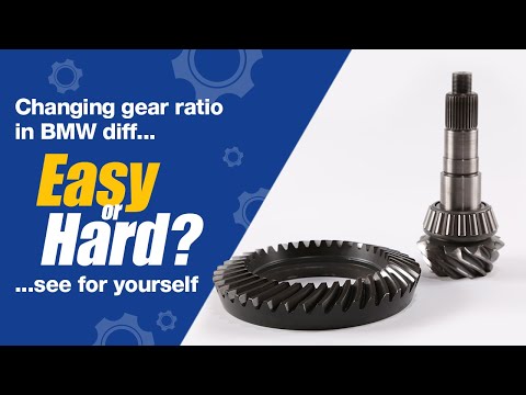

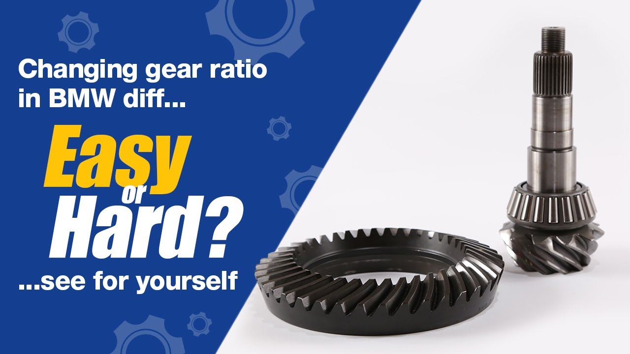

            you might find this informative - they aren't changing cases, but it's all related
            they have a few other vids on swapping cases, rebuilding ls units etc.
            there is a bunch of torque values and other crucial info not included, but the assembly and disassembly process is fairly good.
                  Thank you for that useful link!
