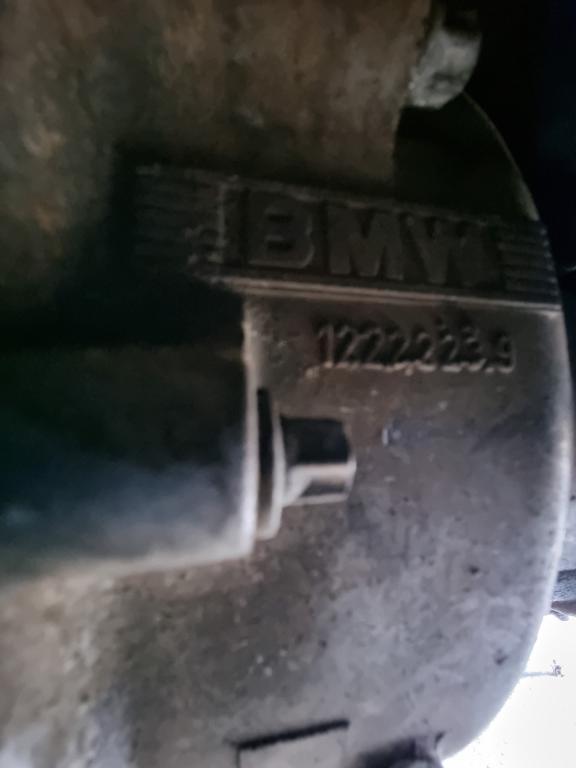

    Can anyone out there help me identify my gearbox? I cant find anything helpful with the codes.

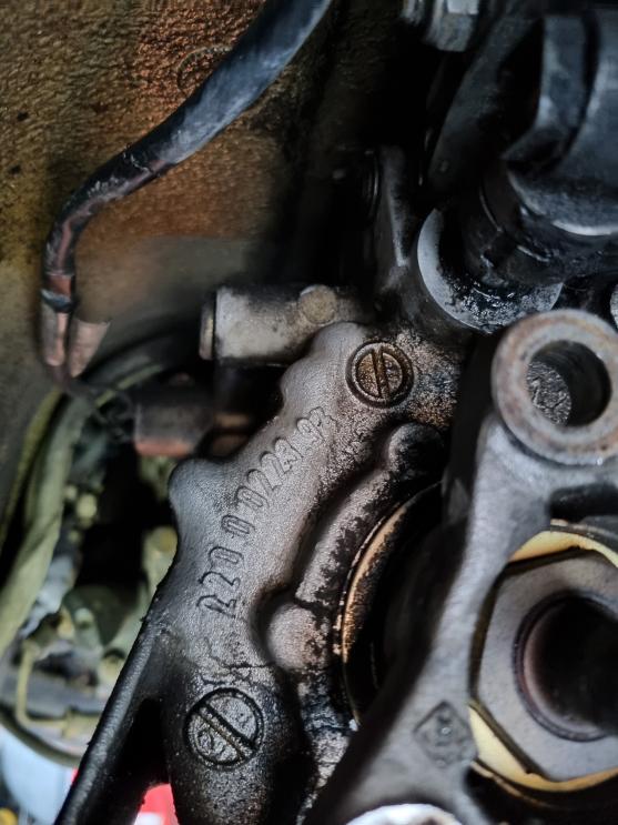

    It's a Getrag 220. Look at the first three digits of the second photo.

            final rant- the casting numbers don't tell you what transmission you have. It's frustrating, but true.
            All the 220 means on the tail housing is that that casting was originally cast for a 220 transmission.
            If it happens to fit the 320, then it will be on the 320, with its 220 casting number still there.
            It may be MACHINED differently, and thus not interchangeable.
            So when doing the 'what transmission' question, it's a good idea to put up as many
            pictures as you can, because in the absence of the sticker on the side, the only
            way to be sure is to do arcane things like counting ribs, comparing bracing, etc.
