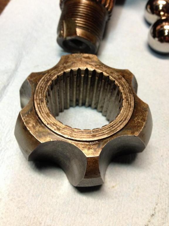

    Click image for larger version  Name:	31947199157_ac89b9ef73_b.jpg Views:	0 Size:	51.9 KB ID:	10056713
    Does anyone know if this side of the inner race faces the end of the shaft (toward the wheel) or the middle of the shaft (toward the diff)? I read that on the E36 shaft, it faces toward the diff but when I took my axle apart, mine was facing the end of the shaft. The E36 and the E30 outer joints look almost identical so I am wondering if these were installed the wrong way around in a previous rebuild (by another owner) or something and that is what is causing my play? Anyone rebuild a E30 shaft outer joint?
    The other side of this inner race does not have that lip on it, it is flat/smooth.

      Check that you do have OEM shafts. You will see GKN or Lobro stamped onto the CV. Also, the OEM shaft will have the "bamboo knot" in the center. GKN replacement shafts are the same diameter through, but are as thick as the "knot" on the OE shafts. Aftermarket stuff has play and the cages are significantly smaller - to the point that the Asian parts won't the OE parts. We tried aftermarket shafts in the race cars, they were lucky to see 30hr. New GKN shafts last us the life of the car.

          I took the outer joint back apart tonight and my previous post was wrong. That inner race lip faces inwards, not outwards so I think it is installed correctly. I cannot slide the inner race all the way onto the splines the other way either.
          Does anyone have any thoughts on how well a weld around the circumference of the shaft where it touches the inner race would hold? Is that a better or worse idea than filling the splines with an epoxy to eliminate the play? May not be very serviceable in the future but the play and clunking drive me nuts and new GKN axles are not exactly cheap by the time they get to Canada.
