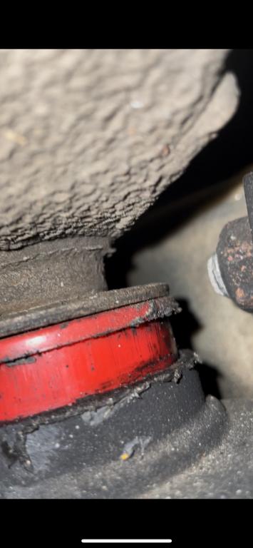

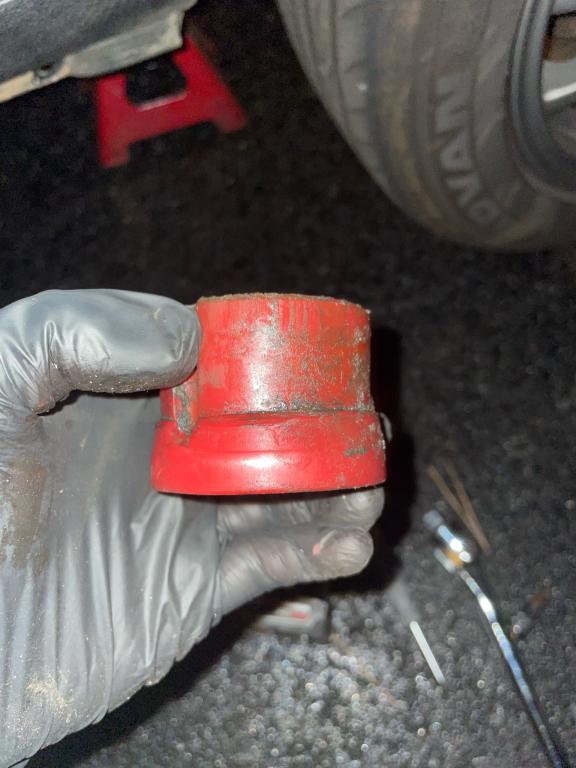

              • cdl723
                • Jan 2015
                • 144
                I had something similar happen with my DS, but it would vibrate when decelerating. I found out it was a combination of my trans mounts (80a thru bolt) being compressed and the rear subframe sagging on the Garagistic 80a mounts. This cause the diff pinion angle and trans angle to be out of alignment by 3-4*. The U-joints on the DS accelerate and decelerate as they spin and the greater the operation angle the greater the angular acceleration. I think the trans and diff angle need to be at equal but opposite angles (-1* and +1*) to cancel these vibrations out.

                        • cdl723
                          • Jan 2015
                          • 144
                          Originally posted by grantmiller1
                          The vibration is more pronounced when I accelerate. When i let off the gas, the vibration is noticeably less.
                          I'll see about getting a digital angle measurement tool.
                          I have new trans mounts on order. My rear subframe mounts (Garagistic 80A) are only 2 years old, I hope I don't have to replace those!
                          I believe mine would vibrate bad under decel, but go away when i pressed the clutch or accelerated. Here is a picture of my subframe bushing when they failed. the 2nd pic is in the car and the room on top of the subframe/bushing.
                          Also, these were their raised subframe bushings and the diff was properly spaced down
