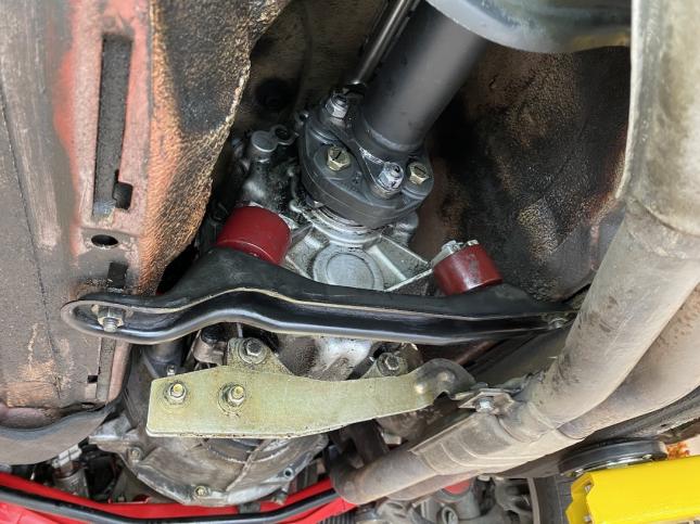

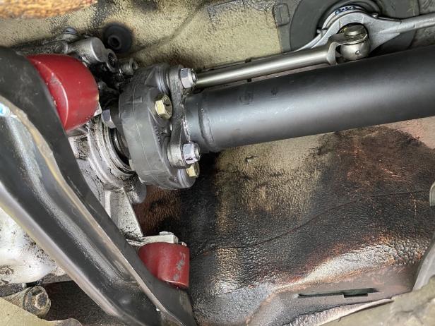

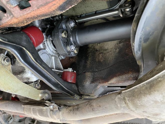

    Attaching pictures of the new guibo to see if I've done this correctly:
    Thanks!

                There were no gearbox mounts in the pictures, are they original or have original dimensions? Guibo in the second picture was "angled" and that 100% sure makes vibration if that is the case when driving. But it should be straight when everything is original and mounted correctly.
                  I noticed the driveshaft angle as well but it could be because there's no trans mount. Is the nut in photo Forum contacting the transmission? Do you get more space when the trans is fully mounted?

                        I re-torqued the trans bushing bolts to the correct spec 9-12 ft-lb and took some pictures of the trans mount for y'all.
                        Confirmed that 3rd gear @ 70 MPH has no vibration.
                        Took a short drive and no change in vibration.
                        I don't feel any part of the guibo or bolts/nuts hitting anything when it's up on the lift. There's clearance between it and the trans.
