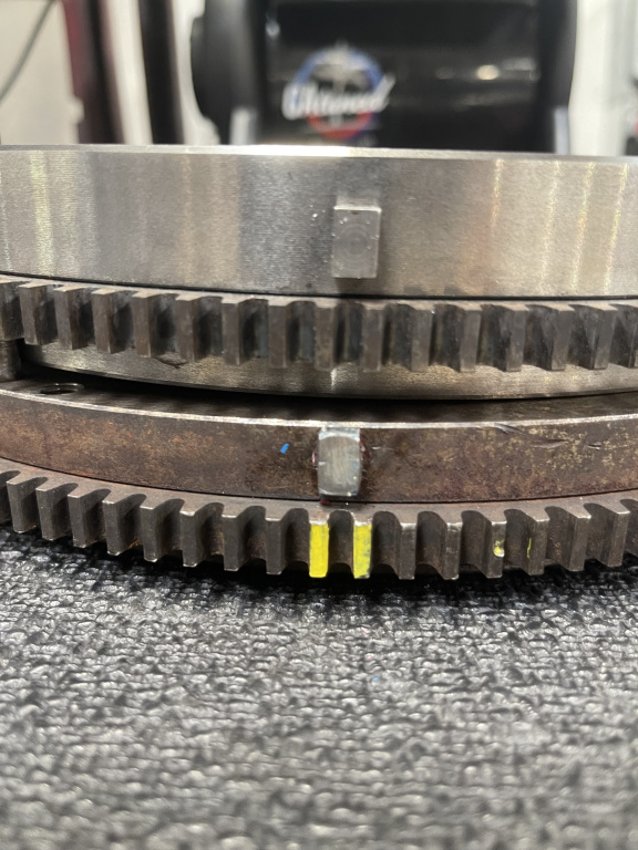

    See pictures of flywheel comparison and bearing measurement.

            I haven’t found any information so here’s my solution. I drilled and tapped the “i” flywheel, measured the pin to ensure i have the correct dimensions. Used a 10mm bolt and shaved down the edges to make it rectangle, used some red lock tight and went sideways with a punch to ensure it’s locked in there tightly since a socket would no longer fit. I’m going to be throwing the flywheel in monday morning fingers crossed hope it works. I do have high hopes because the differences of the flywheel thickness is only on the transmission side and it’s a 7mm difference, it would be the same as if I were to have it machined off the “e” flywheel. i’ll update this thread asap. If anybody has another solution please let me know.

                  Ok thanks so much for the clarification maybe my measurements are wrong i’ll measure again. Hopefully the custom pin I put on the “i” flywheel works since it did drive before.

                    That makes a lot more sense. I didn’t know that the dual mass flywheels came with the flywheel sensors. Hopefully my modified flywheel works. Thanks for all your help!

                      Namtua looks like you are on the right path with the 325i flywheel, and your mod for the sensor pick up looks factory.

                          SOLVED! Mod for the flywheel pickup on the “i” flywheel worked. I’m still confused about the contradicting information not sure what to believe. But drove the car home today from work and it runs great. Lesson learned, next time get the right parts for the right car would’ve saved me so much time in the long run but hey I was able to do it for real cheap. Thanks everybody for the help.

                            Flywheel mod ended up working! Thanks so much for all your help.
