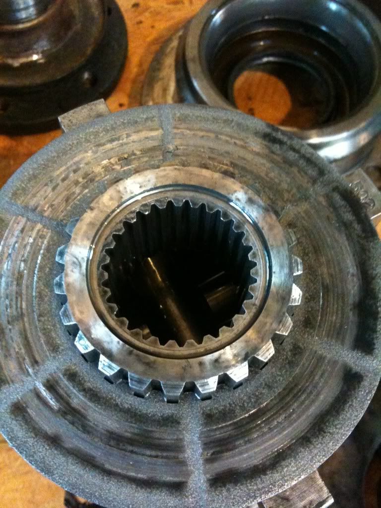

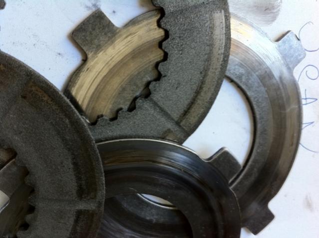

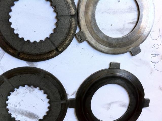

              • Jean
                • 18228
                #127
                My old diff internals, toast/melted and broke free at under 20lbs

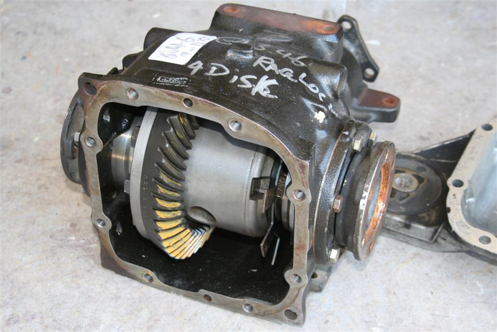

                • shiboujin
                  • Feb 2006
                  • 2791
                  #128
                  pfft, look at this:
                  And this is one of the better ones I've broken down.
                  Status: HG repair. 488wtq though!
                  • Jean
                    • 18228
                    #129
                    Lol, nice! I couldn't take it anymore with mine just spinning one side and runing my dot r tires so it had to go!
