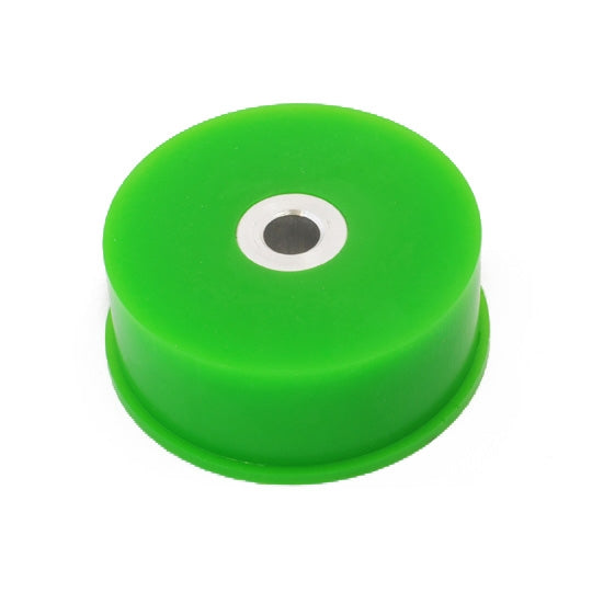

      Try Revshift.
      http://www.revshift.com/product-p/pdb-e30.htm

        I've had a busted OEM diff mount, two 90A Polyurethane diff mount, and a 75D AKG Solid Delrin mount.
        Switching from OEM increased gear whine by a bit, but switching from poly to delrin made little to no difference for me.

          'm going to try the 80A Revshift bushing, see what happens.

                I have the Revshift 90A bushing just hanging out, I'll probably install it this winter.
