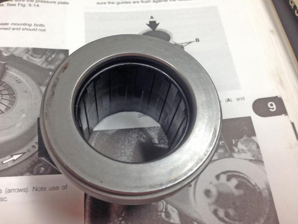

    1. What type of grease is recommended for the guide tube, and the release bearing guides?
    • Bentley says to use a molybdenum disulfide grease.
      • A quick google says that moly grease may be too sticky and not allow the throwout bearing to slide properly.
    • Pelican Parts says White lithium grease.
      • Apparently white lithium grease can't stand the high heat and will break down.
    Suggestions as to grease type?

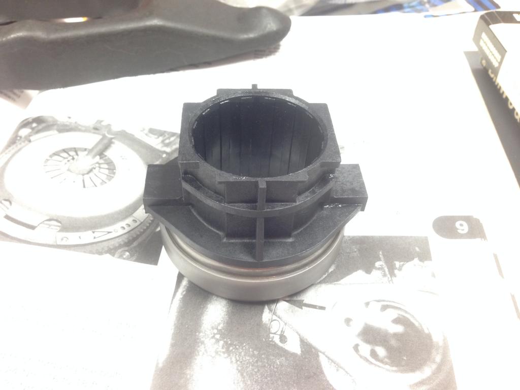

    2. The Bentley manual says to grease the "release bearing lubricating groove". Pelican parts makes no mention of this.
    I am not sure where the lubricating groove is. Please see attached pictures.
    Thanks!

      Check your new bearing- some of them come pre- greased.
      That said, I usually just use wheel bearing grease- it's high temp,
      it stays slippery...
      The groove is inside the bearing sleeve, where it rides on the tube-
      if it's not full of grease already,
      you'll see 2 bearing surfaces, then there's a 'trench' between them
      that you fill with grease.
      It's not super critical- yes, do grease it, but in 10k miles, it's full
      of clutch particles anyway...
      <edit> duh, just looked at your pictures-
      that's a different style of throwout from what I'm used to.
      I'd just smear wheel bearing grease into the notches and
      call it good.
      hth
      t
      Last edited by TobyB; 06-28-2015, 09:55 AM. Reason: I'm too lazy to clicky the pickies...

          Maybe it's a sealed bearing? It came with my clutch kit.
          There is a gap/opening between the edge of the metal flat surface and the plastic tube.
