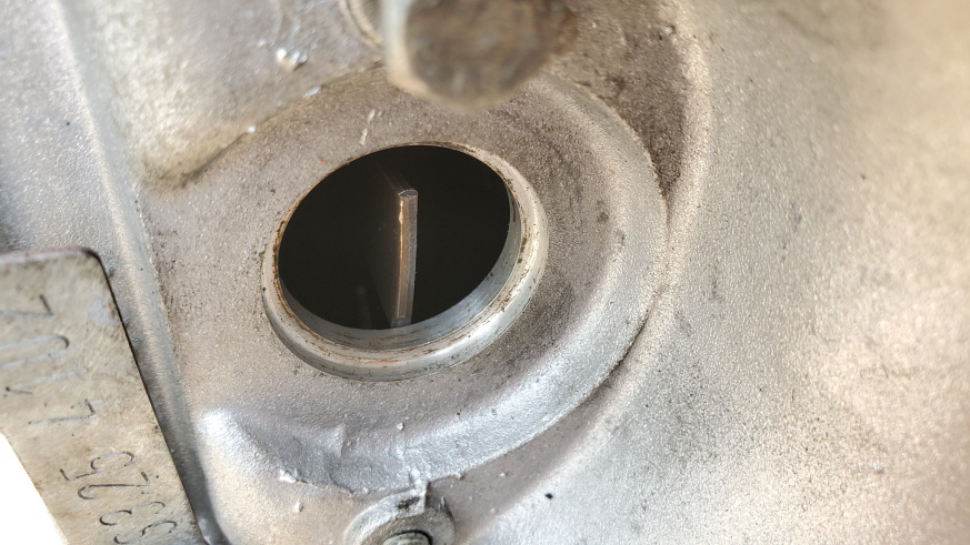

                            • Aleman
                              • Mar 2012
                              • 1598
                              Originally posted by 5Toes
                              limited slip from an e28 535is or 535i with the LSD option. its a 3.25 ratio. just drop out your old diff and remove the rear cover, bolt the rear cover up to the new e28 diff. Then use a large screwdriver and pop out the output flanges and swap those to the enw diff too and install. Use redline LSD rated fluid and have fun.
                              Well damn, I'm trying to do exactly this. Bought a nice, refurbed 535is 3.25 LSD and an E30 diff cover. The bolt holes line up on the case, but the eared speed sensor disc inside hits the E30 diff cover. Anyone else have a fix/modification for this problem?
                              I may need to cut a small valley on the inside of the diff cover to allow the eared disc to spin freely. Is that the fix?
