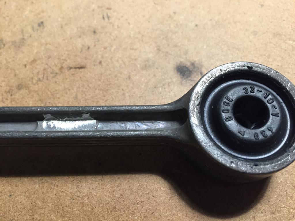

                          This happens everywhere. I ordered a set of Lemforder rear links and this is whats inside the Lemforder box. I don't know why they even try to grind off the brand, but Boge still appear on the rubbers. With so many cross-manufacturing these days, you just don't know what you will get..
                            [ATTACH]108396[/ATTACH]
                            Happened to me with their CAB's.... Lemforder owns part of Boge i guess... i always thought Sachs owned Boge or was a partner or something... who the hell knows anymore lol.
                              Quite likely the ground- off letters were BMW. The OE's often sell through
                              their own chains as well, and rather than have 2 sets of tooling, just grind
                              off the BMW logo. The sharp tool edges are less than exciting, though, on a suspension component.
