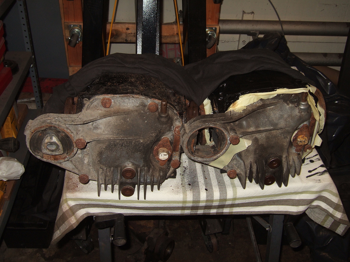

            the rear differential is vented. when the vent is clogged there will be leaking from the speed sensor o ring area
              Interesting - didn't know that. Have been throwing around many E30 differentials, but never seend anything that resembles a vent hole or non-sealed passage.
              @Wanganstyle : Where is that vent hole / non-sealed passage located on the differential?

                thread a few down has a decent photo of the vent itself leaking; if you look inside the cover on bmw differentials there is an interesting block off there behind the vent.

                  Damn, I thought that was a solid metal post. Actually, when taking a closer look at some older photos of two E30 differentials, it looks like that metal post actually have a small hole!
                  Have a couple of differentials on the garage floow, will take a closer look at this area for sure! Thanks for the info!
