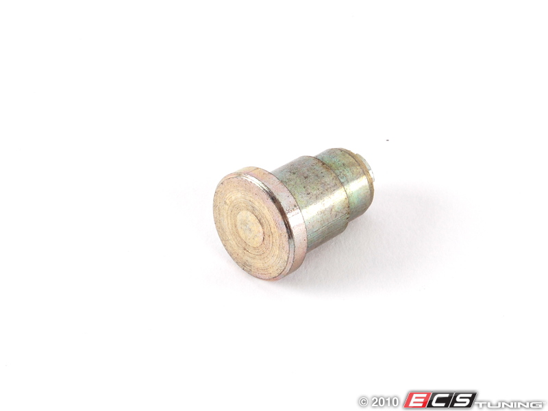

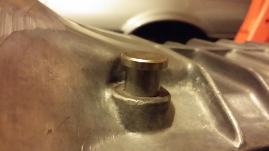

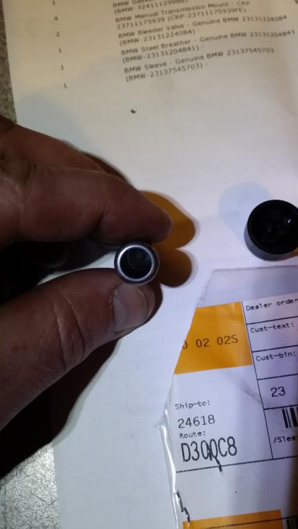

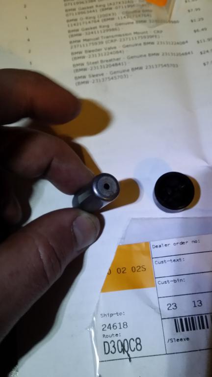

                      interesting....
                      I watched the vid and it looks like you had the fluid already sitting in the tube vent....before you started the drill. Maybe there is something wrong with the vent valve (under the tube)?
                      BMW redesigned that part 3 times for E30. The latest one eliminates the plastic cap, tube and the open top vent valve. It looks like it is all one unit now
                      p/n 23131204841

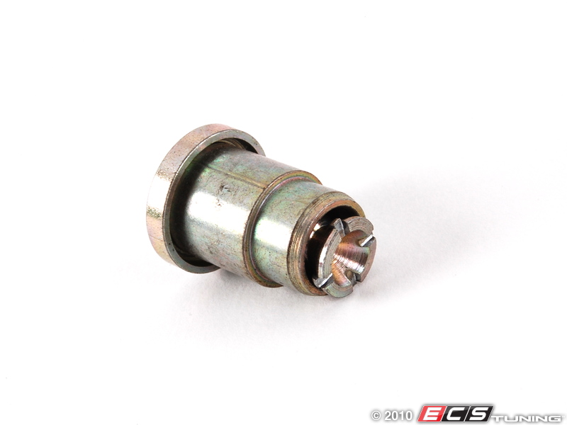

                        • zaq123
                          • Jul 2016
                          • 1466
                          E21,E30,E36,E46,E90,E91,E92,E93.... the above breathe is the only design currently offered to all the above models +
                          There is no pickup tube, what you see in the breather valve is what you get. On older models there is similar but open valve is buried under that little tube/black cap

                            • zaq123
                              • Jul 2016
                              • 1466
                              Old breather design
                              new breather design
