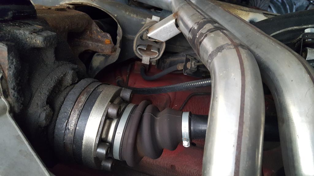

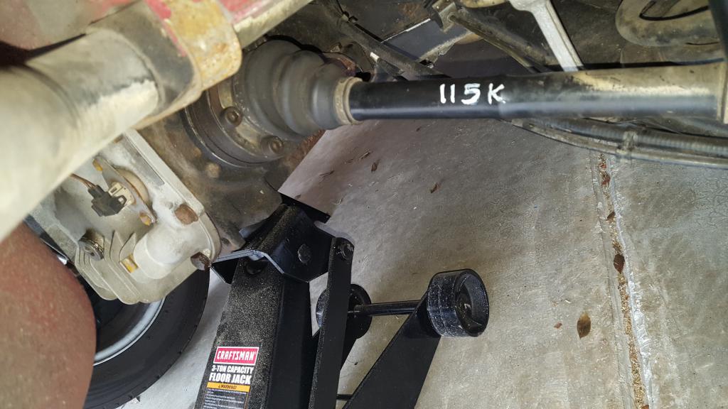

                      Did as you suggested and if I grab the half shaft I can move it in and out and make a clunk. Drivers side seems to move less. I have no frame of reference should there be any axial play? Boots look good no tears
                      Sent from my SM-G920V using Tapatalk
                      • e30davie
                        • Apr 2016
                        • 1788
                        CV joints will move in and out as thats what happends when the suspension goes up and down. What i would be concerced with is laterla movement, which it might not do until it spins.
                        If you think its considerably worse than the other side you can remove the boots and slide them up the shaft and take a look at the CV joint itself. A noise such as your describing should yield alot of destruction.
                        You can wipe all the CV joint grease out for a better look, but you will need to replace the grease if its not the issues. CV joint grease is pretty cheap though.
                        If the CV turns out to be ok, but the CV boot back on and put a decent cable tie around it. Preferable to use a stainless steel cable tie. they are cheap as too. ($4 for a pack of 10 from my local hardware)
                        If the CV is stuffed, start removal of shaft.

                              Looks like everyone that said CV is right. Drivers side looks new but passenger side was either replaced with one that had 115k or was replaced at 115k which was 170,000 miles ago.
                              Saw some ones that must be Chinese for $50 which scared me; has anyone used GKN Loebro 33211226901 - CV Axle Assembly; Rear
