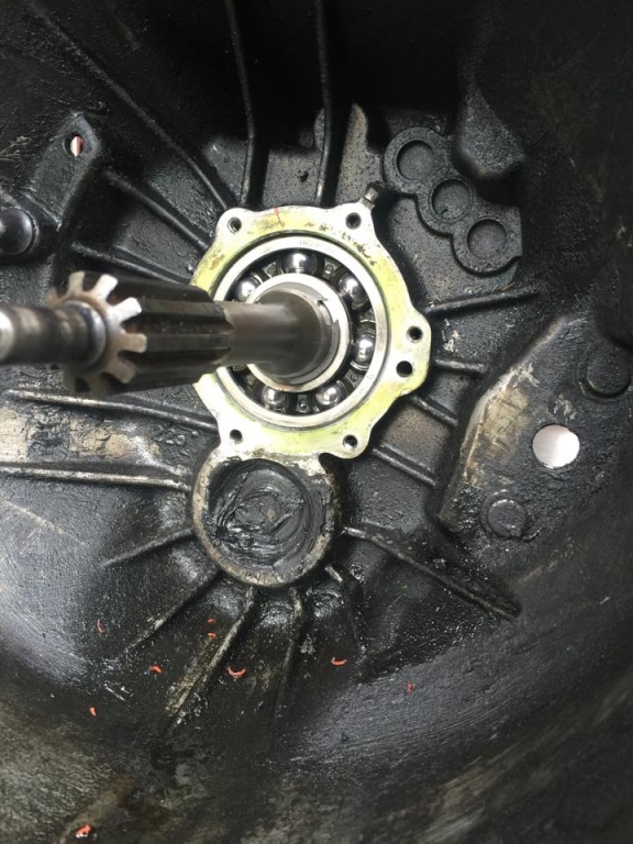

              • LowR3V'in
                • 4209
                What tool do i need to take the clip off the input shaft?
                not my picture
                • e30davie
                  • Apr 2016
                  • 1788
                  is it a circlip? if so youll need some circliip pliers.
                  I went down the google rabbit hole and came across this
                  instructions on the tool you will need to push the input shaft through that bearing. I've got a dodgy gbox at home, i might do the same to mine. looks easy enough.

                        • LowR3V'in
                          • 4209
                          na, so i got clip pliers and i couldn't figure it until the end, but, had to get an angle grinder.
                          Every bolt on this thing is completely off and the clip is off the shaft.
                          Can't get it off any advice?
