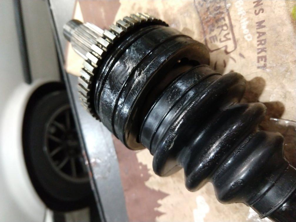

              Your picture is not an E30 half shaft. Trust me, there was only one place to stretch the boot to and it wasn't happening by hand.
              The diff side was easy. Nothing required.

                Here's the outer side. It's impossible to remove and repack the joint without removing the boot, and the boot is the last thing to go back on after it's re-assembled.
                Maybe the old OEM boot goes on by hand, but that's a no-go with the rebuild kit.

                  The picture is of a GKN E30 axle.
                  I'm not going to keep going in circles. This is a job I've done dozens of times and have described it as simple as possible.
                  Do what you will.

                    Are there two different style axles???
                    • AndrewBird
                      The Mad Scientist
                      • 11898
                      Looks like the wrong boot for sure. Should just slip on, no stretch.
                          You take off one of the CV joints and slide BOTH boots on from that end. It sounds like you already took the inner CV off, but didn’t put both boots on at the same time.
                            I wasn't just replacing boots, I cleaned and re-packed both sides. Otherwise, ya, you could just remove one side and replace both boots.
                            I wonder if the OEM boots were the same when they were new, and over the years they've just held the larger shape?
