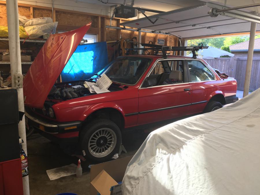

      Reverse lights! It starts!! It runs!! R12345 all spin as normal!! Unbelievable.
      Bleed coolant, bolt up skid plate, back it out of the garage and see if it rolls................

        Bled it, tested around the neighborhood, took it (easily) up a nearby canyon to run through all the gears. It's a different car now.

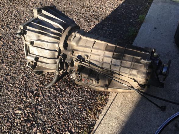

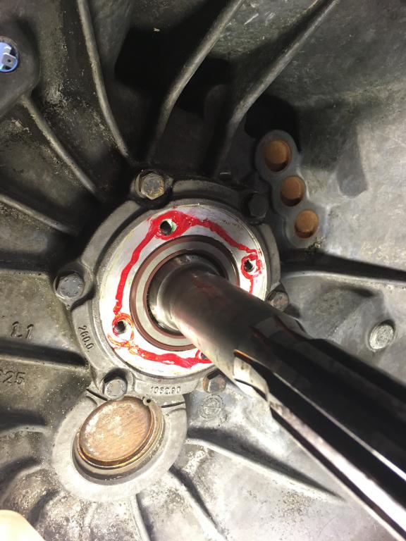

              Good riddance!

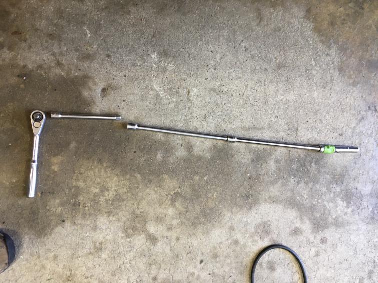

              Advice - get yourself one of these. 25 bucks for the day.

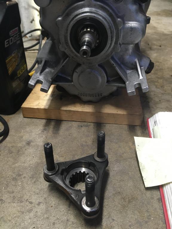

                Followed advice and pounded the splined studs out of the output flange, got rid of the harmonic balancer frame, popped them back in. Used a deep socket and a 2 lb hammer.
                Click image for larger version  Name:	IMG_6253.JPG Views:	0 Size:	59.4 KB ID:	9944835

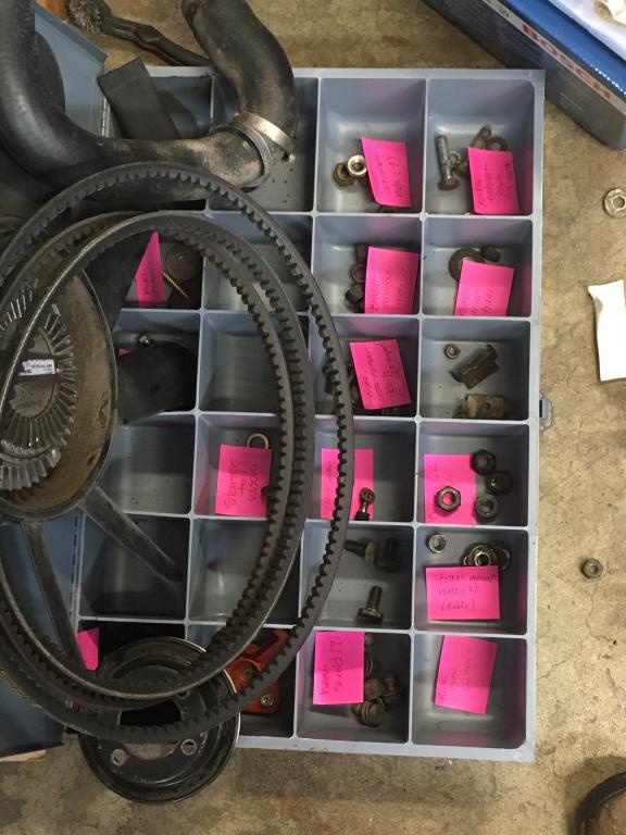

                I number the bolts so I remember which are torqued.
                Click image for larger version  Name:	IMG_6256.JPG Views:	0 Size:	42.0 KB ID:	9944836

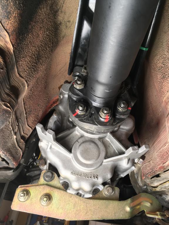

                Marked the bolts to show torqued twice.

                    Rebuilt driveshaft by Driveshaft Specialist Inc in Texas. Super fast turnaround.
                    Loosen center collar to adjust spline length to fit at giubo and diff flanges. Center carrier slid forward 6mm from resting position, then torqued down. Then snug center collar back up.

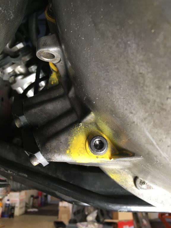

                    This is the one non-e torx bolt we had to use. High strength metric cap screw. It had to be 90mm long to stick through the bellhousing.
                    Click image for larger version  Name:	IMG_6272.JPG Views:	0 Size:	46.7 KB ID:	9944856
                    Because....
                    Our odd duck (?) transmission has a very deep casting boss just below the crank position sensors and the normal 50mm bolt won't even reach to the flange. The part # is an early E30 manual, so I don't know why that is.
                    Click image for larger version  Name:	IMG_6275.JPG Views:	0 Size:	50.5 KB ID:	9944857
