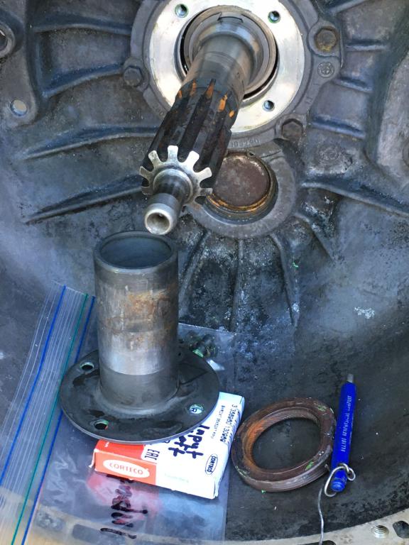

    3. Should I take a strip of emery cloth to the output flange to clean it up? There's some black areas where the seal ran, but nothing you can feel with your fingernail.

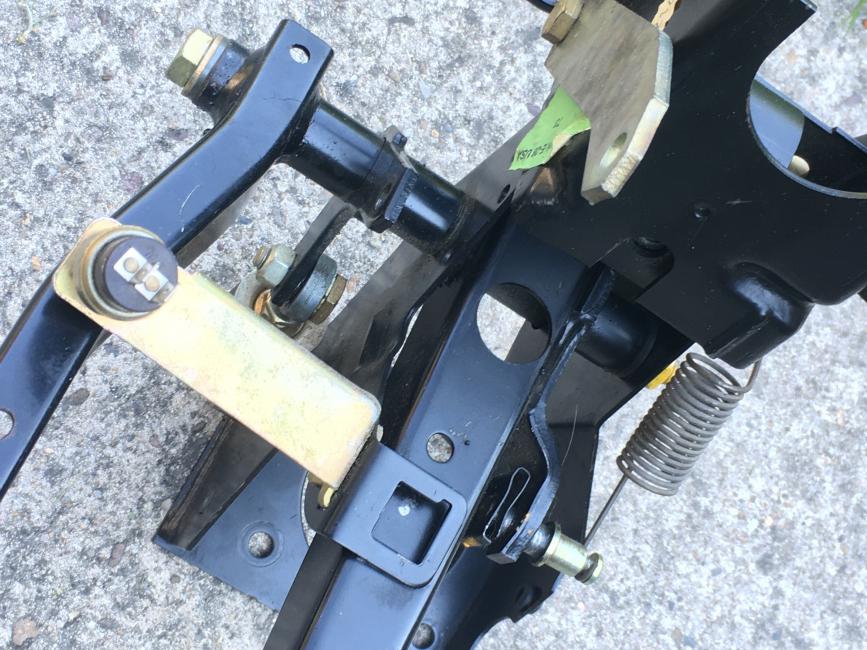

    4. I found a pedal assembly not from the donor car, maybe from a 528e. Bushings seem smooth. It looks right, but has an extra bracket on it and I just want to verify it's gonna work.
    What is the zinc-plated bracket mounted here? It pivots on the bolt axis. I don't see this on E30 diagrams. Just remove it?
    Click image for larger version  Name:	pedals9.JPG Views:	4 Size:	97.5 KB ID:	9940351
    Is this the correct set-up for an E30? The switch on the clutch is a neutral safety switch? Or a cruise control switch?
    I also ordered a brake switch mount bracket that's a different shape than the one with the square hole here. I use the same brake switch that's already on the car?
    Click image for larger version  Name:	pedals12.JPG Views:	4 Size:	104.2 KB ID:	9940352
    Click image for larger version  Name:	pedals11.JPG Views:	4 Size:	86.5 KB ID:	9940353
    When we're done, the pedals should be in the same plane, correct? Not like this. Do the switch brackets adjust the pedal height, or the master cylinder attachment?
    Click image for larger version  Name:	pedals10.JPG Views:	4 Size:	98.1 KB ID:	9940354
    As you push the clutch pedal in, the spring goes over center and pops out the top. Something else must keep the spring and arm from going too far, but then how does the clutch pedal go to the floor?
    Click image for larger version  Name:	pedals8.JPG Views:	4 Size:	91.8 KB ID:	9940355

    Some emery cloth to clean up this input seal sleeve? It's smooth to the touch.
    Click image for larger version  Name:	Input shaft.JPG Views:	0 Size:	74.6 KB ID:	9940364

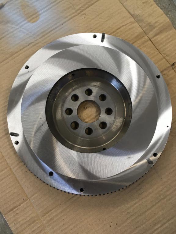

      The flywheel. Thickness machined surface to outside of ring gear is about 28mm. Total thickness 37mm. One square trigger on the rim. Three pins.

              OK....realOEM shows two different numbers for the pedal assembly.
              E30 5/86, no airbags: # 35111157719.
              E28 (528e) 5/86: # 35111157728.
              E30......
              E28......
              Ours.....
              Ours clearly has the E28 bolt flange. Used parts man conned me. "Oh, they're all the same piece."
              Let me look to see if that flange unbolts or could be cut off.
              • LateFan
                • May 2013
                • 4432
                Yep, I think they're the same piece with an extra bracket stitch-welded onto the end of the 528 piece. I'll see if I can get a grinder wheel or a dremel in there.
                • LateFan
                  • May 2013
                  • 4432
                  Cut the welds with a dremel cutting wheel, cleaned them up with a grinding wheel, primed and painted. Bingo, an E30 pedal box out of a 528e pedal box.
