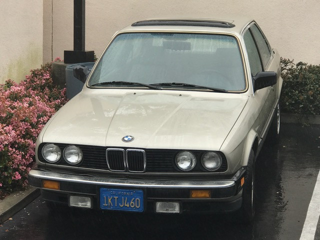

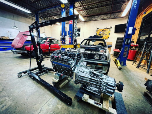

    LS1+GS7 DCT into 318i

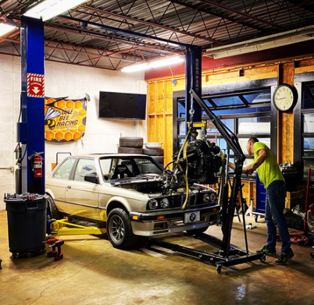

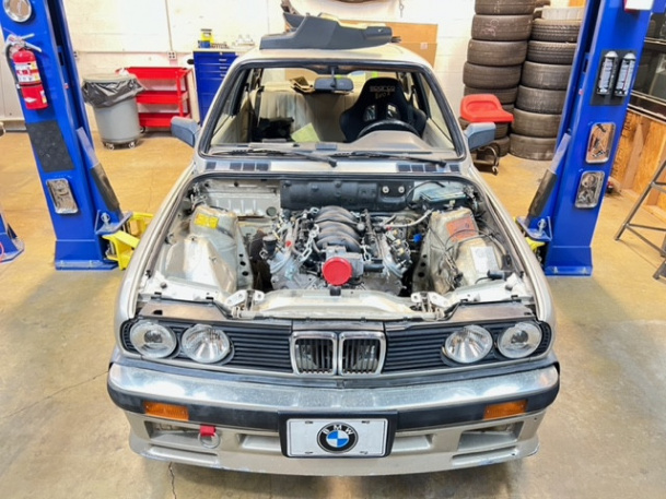

    This is not a swap thread that will resolve itself quickly as I only have a few select weekends each year to work on the vehicle, but I am going to try to make the most of the moments I can. Picked up a very straight '85 318i Auto a few years back. The plan was to put an M20 2.7L stroker in it, along with a manual trans. I was fortunate enough to have access to a heavy surplus of race parts from a guy who moved on from E30 Chump Car racing. Got so far as to dropping in the new engine and trans, but then asked myself the question that one should never ask oneself: "Do all roads in fact lead to LS?" Needless to say, that set into play a series of costly events, along with thousands of hours of web sleuthing and YouTube video watching. Next thing I knew, I had sourced a cherry, low miles, LS1 from a '99 Corvette and a super clean GS7 dual-clutch short ratio 7-speed from a 2013 S65 M3. I'll try me best to keep this up to date, but feel free to ask questions if you have any. I have a plan, but I also know there will be much discovery along the way. You can also follow along via my insta @time_to_wrench. Let the fun continue!

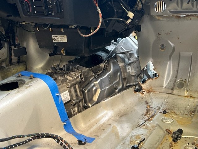

          Next big push is definitely transmission tunnel. As my brother put it, this is "a huge donkey d**k" of a transmission. Length isn't the issue, it's height. I'll probably need to raise the tunnel an inch or so upward. Also, I wanted to keep the engine as far back as possible, and with the 30mm Domi-works trans adaptor plate, I need to create some additional clearance along the firewall. Interior needs to be completely removed to tackle the metal work. I'm trying my best to preserve the interior, but the heater-box is going to give me some challenges. I'll know more once i get the tunnel opened.

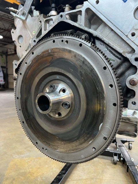

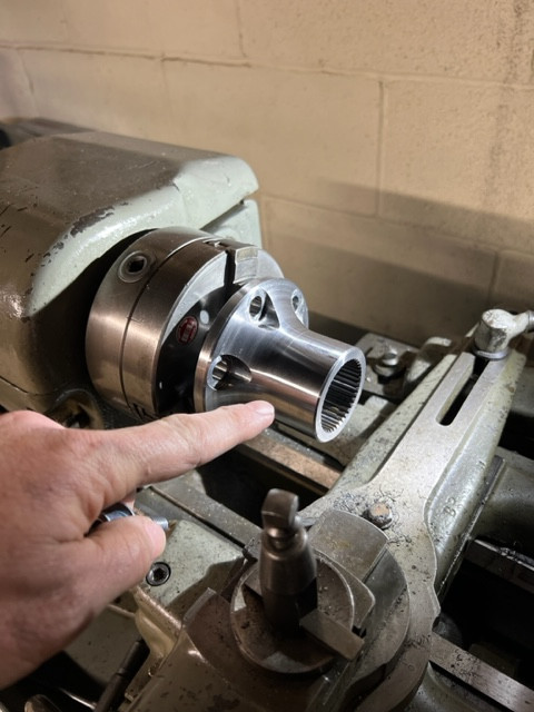

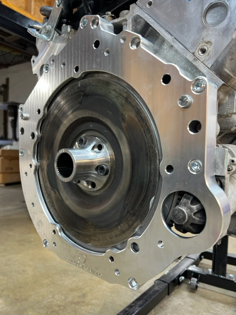

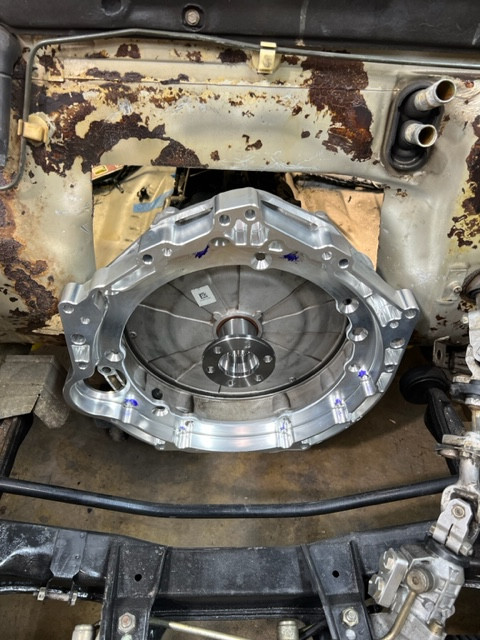

              I've been remiss in giving any updates. Still working on fine tuning the fitment between the engine, trans and flywheel via the DomiWorks adaptor. First, DomiWorks makes some gorgeous stuff. Their kit calls for a flex plate with a ring gear for the starter, but I like the idea of running a true flywheel, so I shaved down the factory LS1 Corvette flywheel to clear the adaptor profile. That meant I also needed to trim the face of the crank hub adaptor because the flywheel is substantially thinker than the requisite flex plate. Seem to have resolved all of fit issues on the trans to motor, so moved on to cutting out the trans tunnel to get enough clearance for this beast. That's where I stand as of now.

                Originally posted by midfat
                Click image for larger version Name:	Unknown-16.jpg Views:	0 Size:	97.4 KB ID:	10083131
                That's a great picture!
                Trans sitting in it's final position there, or is there still more to massage?
                • midfat
                  • Mar 2017
                  • 13
                  Definitely needs some further massaging. I think I can get it another inch or two back, but that'll require some more side clearance. I need enough for the trans cooler lines. Once I get it placed, I'll box in a new trans tunnel. My hope it to be able to keep the heater-box. We shall see...
