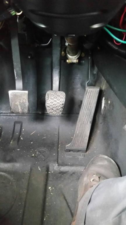

            For those that wanted a picture of the pedal clearance with the wilwood clutch hydraulic kit. I did move the fuse box and headlight harness over an inch and bolted the pedal as far to the left as I could. Firewall was reinforced with a 1/8th inch plate, otherwise it would flex too much.
