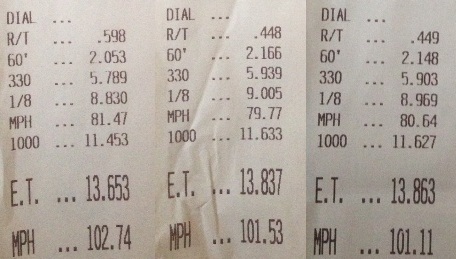

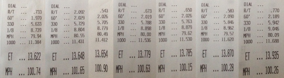

                Finally got back to the drag strip. Conditions were similar to last time (July 2012), temps were in the mid to high 80's.
                The car is 2680lbs, m60b40 with chip, cone filter, full dual 2.5" exhaust w/o cats. 5 speed ZF310 with Clutchmasters FX100 m52 clutch. 235/40/17 Sumitumo HTRZ-II's.
                There was tons of grip, the track was prepped great. I wasn't spinning at all, and definitely could have launched with more throttle.
                The only change in the car since my runs in 2012, was switching from a 3.25 LSD to a 2.93 LSD.
                2013:
                2012
                At least I was consistent this year. The trap speed sucks even worse then last year though. I've seen stock e34 540i/6's with higher trap speeds. So I'm definitely down on power. Still trying to figure out what's wrong with the damn thing. I may hit up a dyno just to get a baseline to see where I'm at.

                    I did some reading, and if you subtract your 1320' time from your 330' time, you get a good indication of your power consistency without the traction factor. This year, my 330'-1320' were all 7.92-7.99. Last year, they were 7.86-7.89. I'm guessing that's the difference between the 2.93 and 3.25, the torque multiplication. If I add my best 330' from this year, when I was hooking up, to my best 330'-1320' time from last year, when I had the 3.25, I get a 13.498. The 3.25 was not the reason I wasn't hooking up, it was track prep (or lack thereof). So, theoretically, the difference between the 3.25 and 2.93 is worth about .1-.2 seconds and 1-2 MPH.
                    I don't really care about drag racing, my car certainly wasn't built to drag race, I just really like getting the data and seeing how changes you make affect acceleration. I would have thought that a diff ratio change would do a lot more then what my times show.
                    Originally posted by dirty30
                    Maybe the low trap speed and the stalling are pointing to a compression or base timing issue?
                    That's what I'm thinking. I'm going to recheck compression, and pick up the timing tools. If I don't get it sorted by the end of this summer, I'm buying a different m60, and an m62, building a hybrid, and not using a single nut or bolt from my current setup. And if I still have my issues after that, I'm going to jump off a bridge.
